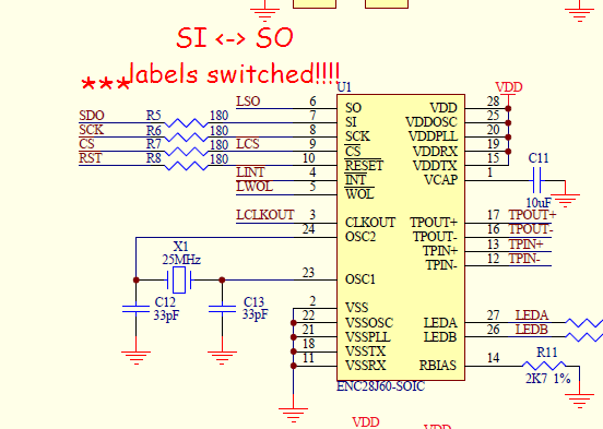

ENC28J60 beware switched Net labels
This ENC28J60 PCB has the net labels for serial in and out swapped. I would have thought the net labels on the PCB connector would match the functions of the pins that are to the chip. I was wrong.
