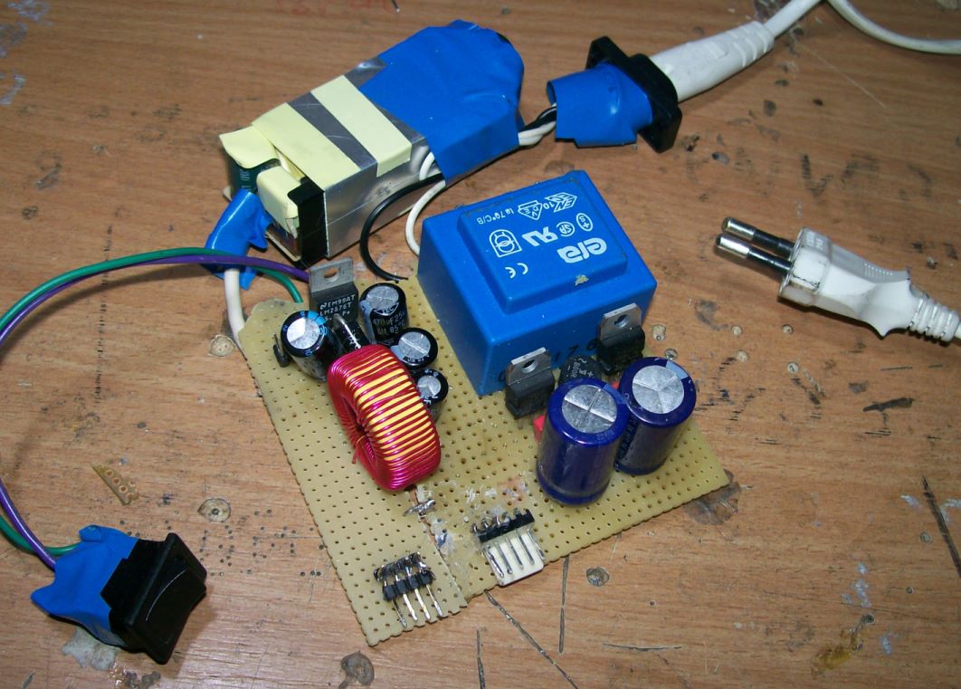

All in one +12/-12/+5V PSU for SID, FM and SEQ
Assembled from the following parts:
A cannibalized 220V - 12V/3A switching PSU powering
a LM2576 step−down regulator 5V/3A.
A dual Transformer 220V - 2x15V powering
LM7812 and LM7912 regulators.
