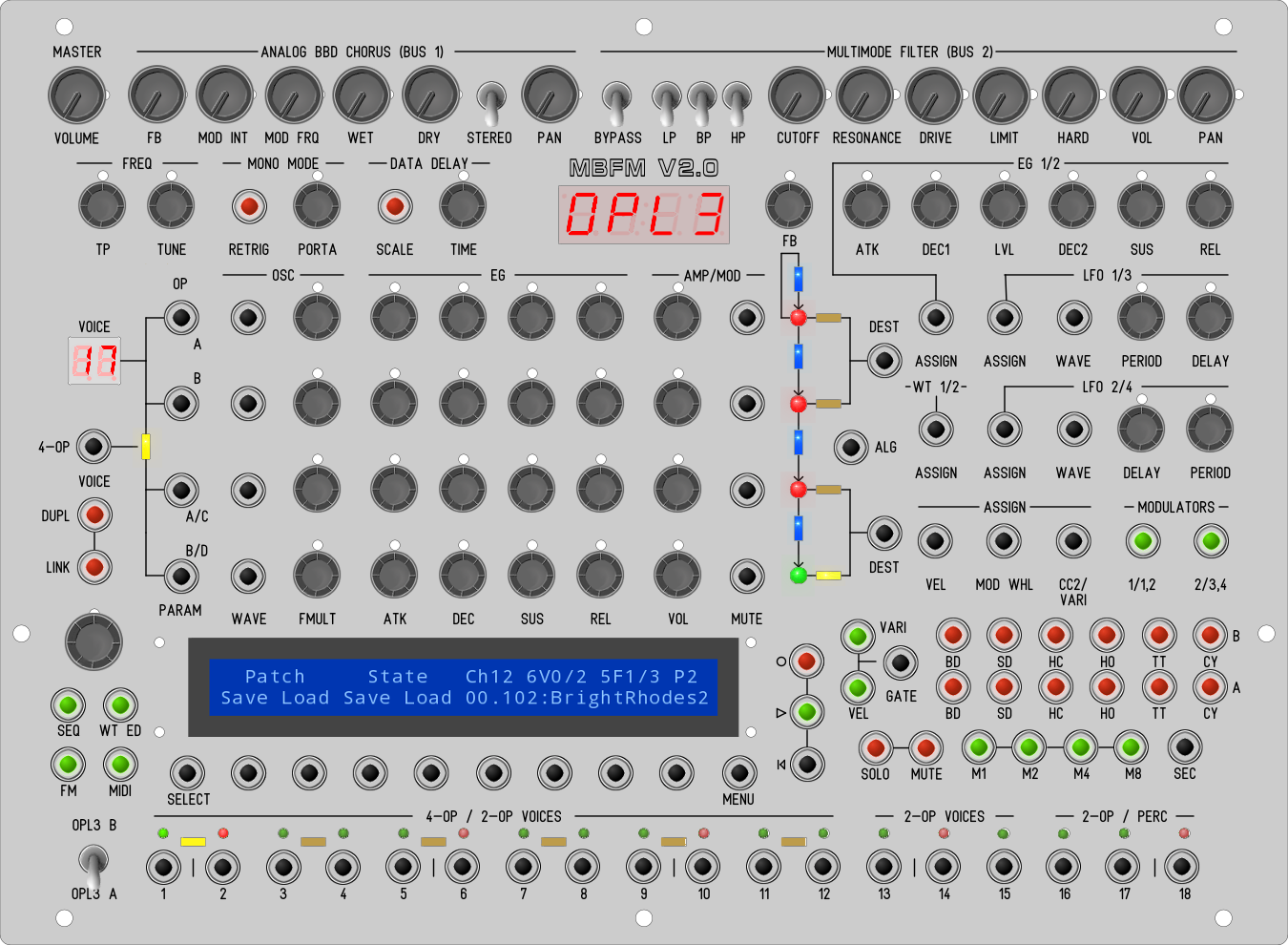

Starting to look real legit! :smile:
For each of the non-lighted buttons, you hold it down and options come up on the screen for that setting, and then you press the softkey below the option you want. For example, hold down Wave and you get the 8 waveforms as choices across the screen. Hold one button and press another is, to me, quicker than scroll through options with an encoder.
If you don't have the front panel space or are not so inclined for some reason, you may build only one or two of the operator edit rows.
