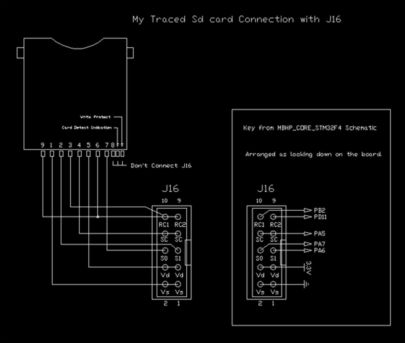

Drawing of my continuity test on my Non-Functioning STM32F4 + SD Card Connector.
View is from the top of the board looking down onto the pins and SD card slot.
