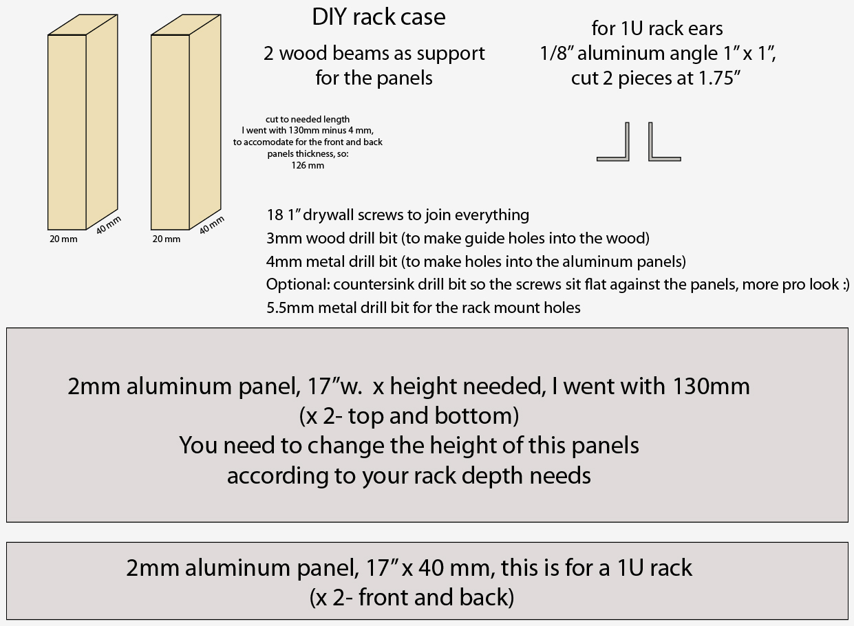

diy rack case
rough plan for the diy rack case

Thank you very much!
the "wood" trick is really nice!
The trouble for me is too be able to find 1"x1" aluminium angle (here in france it's mm, so 30mm, 20mm, but 2.54 :wacko: )
