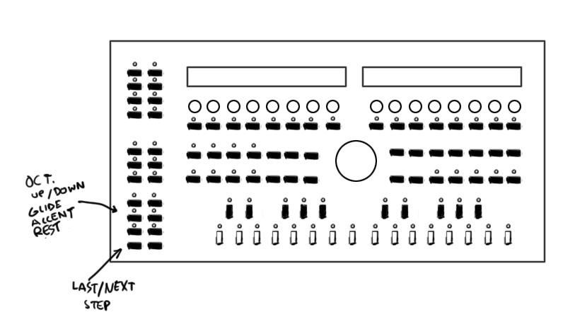

  2. I think this might the best layout of the ones presented, too. I imagine they are buttons that one would press quite often, so at the right they are easy to access and not in the way. In fact it might better than having them horizontally, because then you're hand would be constantly blocking the keyboard when pressing them. Oh and obviously the octaves will follow the buttons, with the highest octave keyboard at the top and the lowest at the bottom. I can see that my unfamiliarity with Midibox is showing. Still, I wonder if there are pages where the keyboard and its LEDs could provide some additional functions (arpeggiator, custom delays (e.g. if your delay repeats 8 times you'll see 8 green LEDs on the keyboard, pressing a key turns the LED red and mutes that repeat, so you could have 6 repeats - mute - one repeat) or easy access to presets on certain pages)?

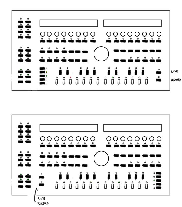

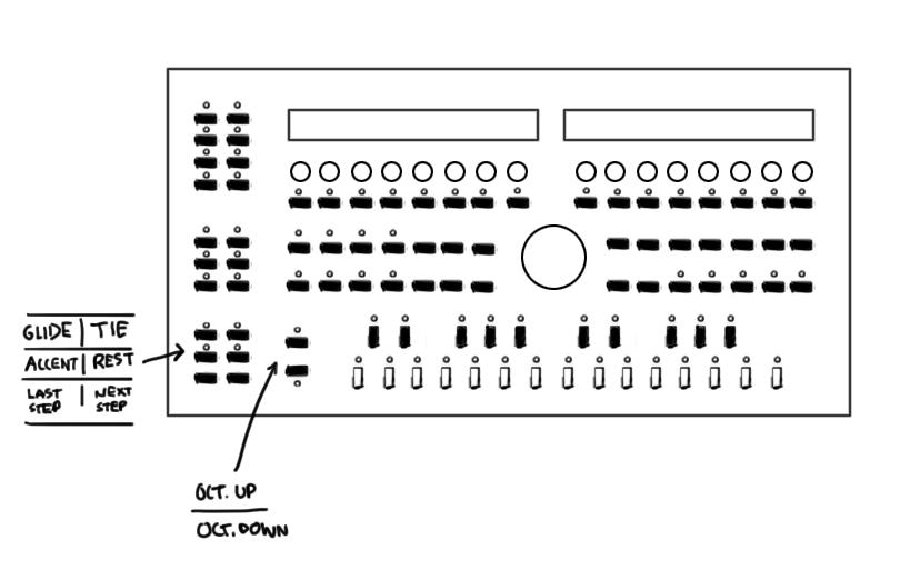

  3. Thanks for the clarifications regarding glide and accent. Sounds good. That sounds sensible. Regarding extra buttons: - Would the octave buttons be hard to fit on the interface? - A button to jump into 303 mode from whatever page/view you are in (and pressing it again jumps you back to where you were before, so you can easily switch between two pages). Or would live/record buttons serve the same function? - Midi remote functions button? So you can use the keyboard buttons to launch patterns, input characters or whatever (maybe a feature for the "do later" pile) Here's a sketch with a few more buttons (octave buttons + live and record). The octave leds would probably make more sense in a horizontal line, e.g. under the central encoder, but it would be difficult to place any buttons near it without moving the keyboard down a lot (thereby making the the whole thing much bigger than it needs to be). So I've placed them on the side for the time being. I also coloured some of the LEDs, but they're kinda hard to see.
  4. Another possible use for Duo-Colour LEDs: Instead of showing accent (as accent is indicated by the accent button led, though it doesn't show which notes) ,they could show octave. The keyboard could have two different duo-colour LEDs e.g. the lower octave Green/Red and higher octave Green/Blue. So the keyboard shows e.g C3-C5. When you play a note below the range the LED colour is red. When you play a note above this range it shows up as a blue LED. D2 = D3 key with red LED D3 = D3 key with green LED D4 = D4 key with green LED D5 = D4 key with blue LED So you end up with a keyboard that has a 4-octave range. The problem with this approach is if you are playing several octaves of the same note. If you play D2 and D3 there would be no correct way to show this as they occupy the same key on the interface. Or three octaves of the same note. But I guess this is a problem with any approach.

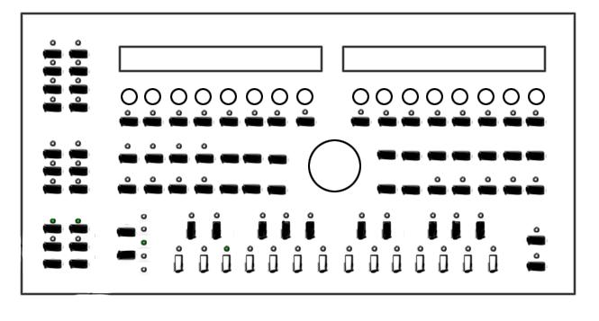

  6. Thorsten, that would be great! The 303-view actually is what made me think that it might possible to implement this. BTW I don't have an urgent need to build a SEQ right now so if you are going to work on some of the features you certainly don't need to rush on my behalf. By "rest" I meant no note, empty note, skip note or whatever. Although I guess this could be accomplished by not entering a note and just pressing the "next" button. However I noticed that a "tie note" button is missing, and also my keyboard design appears to have invented a new note between B and C :tongue: By getting rid of that note there is more room to space out the buttons (although there would be even more room if I moved the keyboard all the way to the right, but my brain demands that it be symmetrical with the big central encoder). Here is a slightly updated design (including the perhaps redundant "rest" button):
