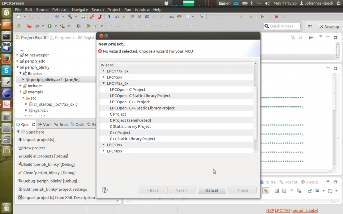

  1. It worked with version 5.x. Thanks a lot!
  2. Ok, I will try that. Thanks!
  3. Hello, I want to build a MIDI controller for my Mutable Instruments Ambika, based on the Midibox NG. I already ordered all the parts and did most of the soldering, and now I'm trying to install the MIOS32 Bootloader on the LPCXpresso board. I'm running on Ubuntu 12.04, and have installed the LPCXpresso IDE v7.1.1. I managed to install the "blinky" example, and the LED2 is constantly blinking, so it looks like the basics are working quite well. Now I'm trying to follow the instructions from http://www.ucapps.de/index.html?page=mbhp_core_lpc17.html. However, I don't have the option to create a "FreeRTOS project". I attached a screenshot of the options I see. Do I have to install any additional software or maybe an older version of the LPCXpresso IDE? Thanks in advance for your help! Cheers!
