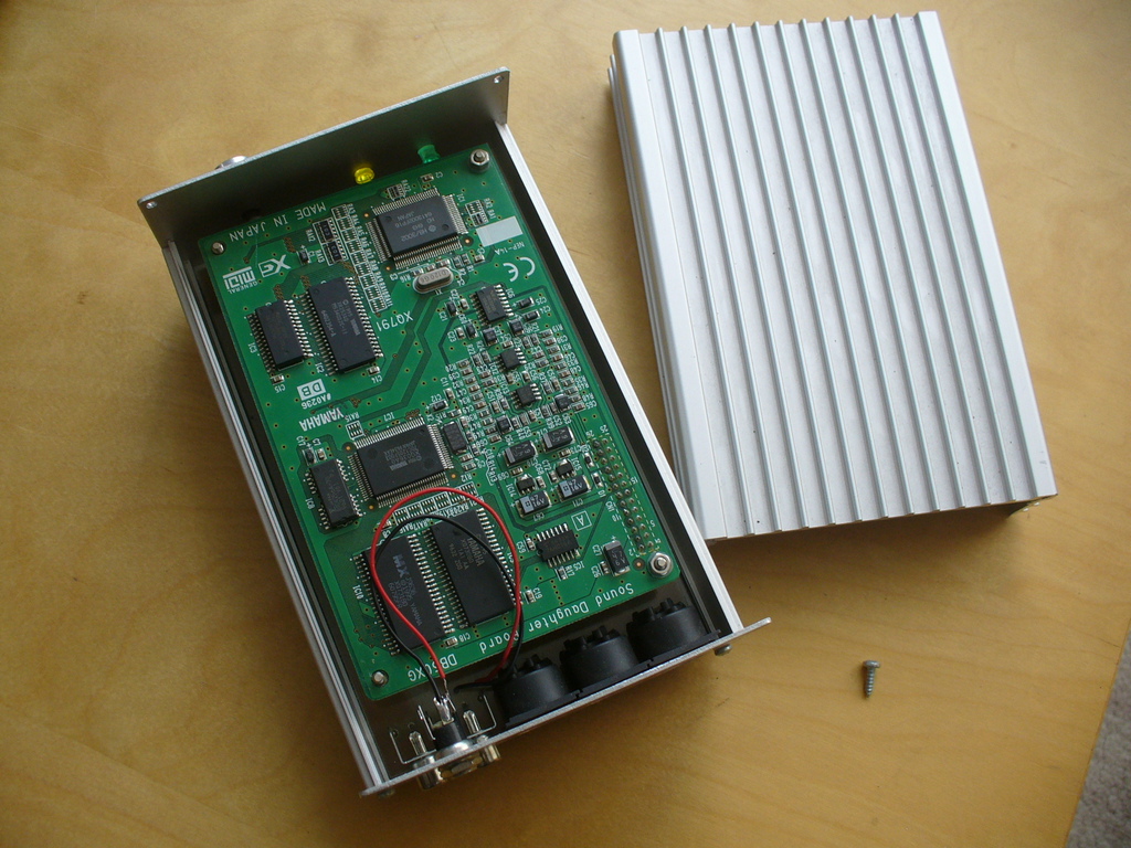

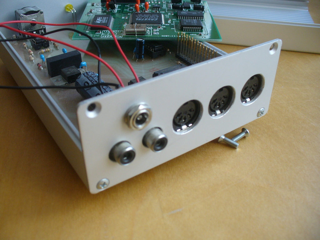

For sale a Yamaha DB50xg Board on DIY-Adapterboard. Mounted in Alucase (see Pictures) Price 90.-EU plus 5.- EUR dispatch to Germany
