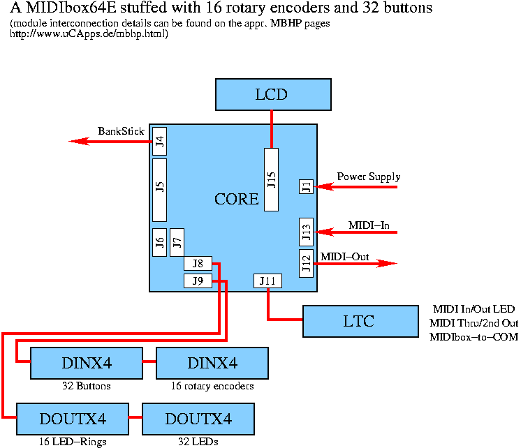

    Just for test i connected led on first 3 pin on DOUTX. With "setup_midibox64e.hex" everything works ok, when i press button led going on. With "setup_midibox16e.hex" leds are always on and in editor when i change shift rgisters to button nothing happens.

    seppoman i know that MIDIbox64Eis what i need but how to avoid first 4 shift registers (first DOUTX module) because in firmware they are for LED rings and i don't need it. So i need to get two DOUTX modules and connect leds only on second module? I use "setup_midibox16e.hex" and my configuration is like this:

    I try this but is not what i need because there is only LED rings and not LED-s with buttons and encoders, but thanx for help....

    Hello. First greetings from Croatia and i must say that http://ucapps.de/ is amazing site for midi freaks. I work on my midi controller for Traktor Pro and everything is set but because i am not programmer i need help with firmware. I need something like this "MIDIbox16e V1.004 - supports up to 16 rotary encoders, 16 LED rings, 64 buttons, 64 LEDs." but without LED rings and for PIC 18F452. Pleae help me because i was try all firmwares from site but this is what i need........ Thanx Aleksandar
