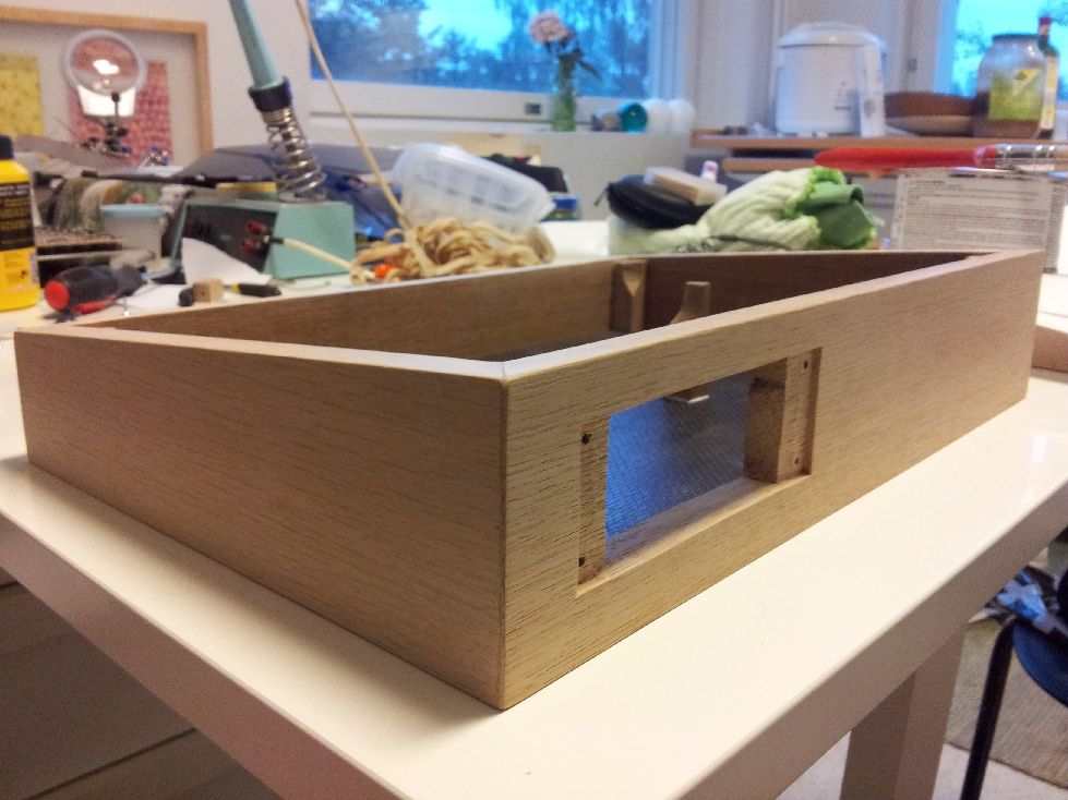

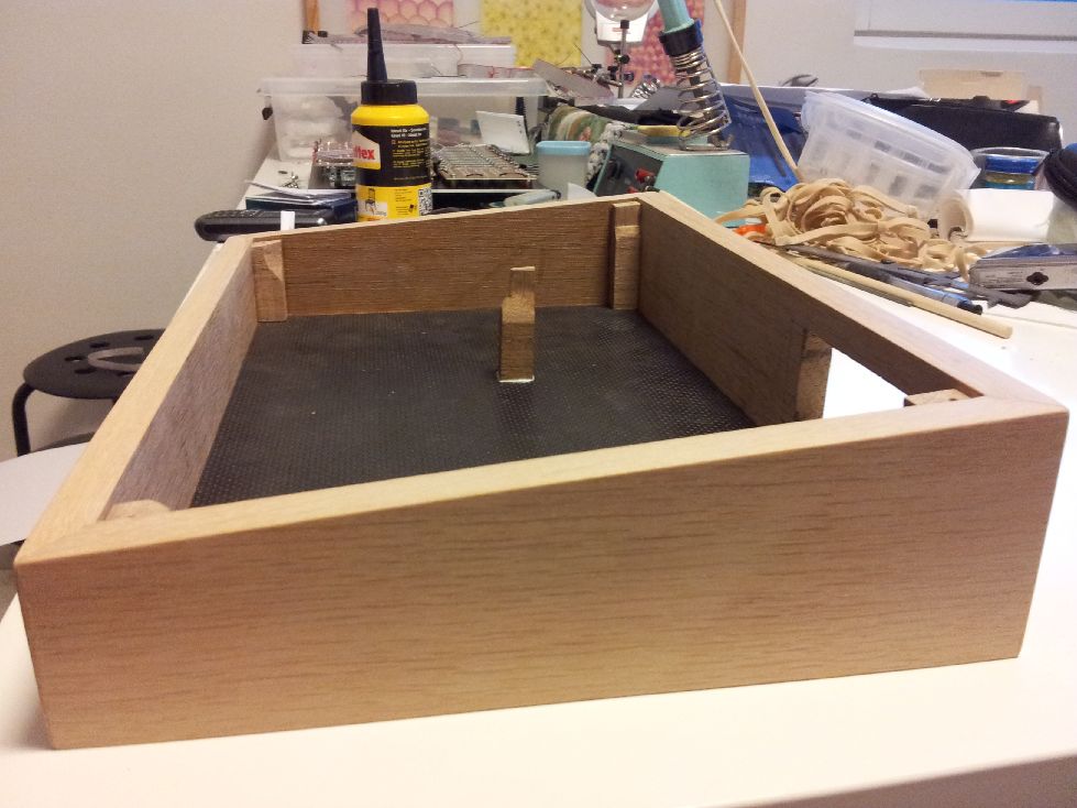

The week I've spent building a wooden case for the midibox. I got some old oak from my father, thats been drying since the 70's, and used that to build the case. I'm not fully satisfied with it, mainly bacause I had to finish it at home, where I dont have proper tools. But it turned out ok anyway. I just lacquered the box, and it's drying, but here are a few shots before staining and lacquer. There's also two bad shots showing the frontpanel assembly, or the point where I've gotten it.
Next up, is fitting the modules inside the box and finishing the wiring between the modules and the panel.
