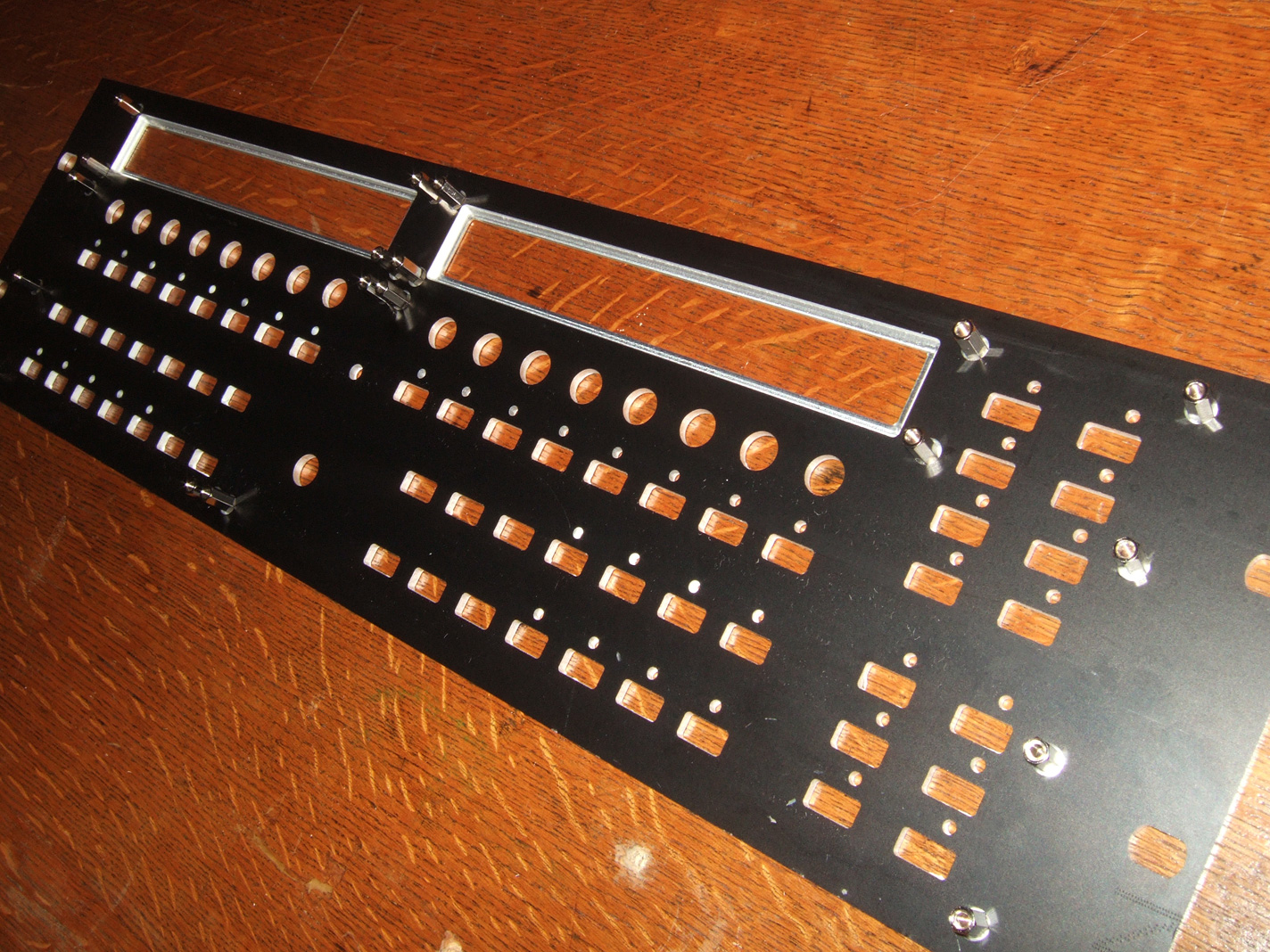

Attatched are some images of a panel made for someone earlier in the week.
As i can't/dont want to get into doing threadded blinds on the rear of the panel, i suggested just milling circular recessed in the back (2.0mm dp) that some threadded spacers could be 'sat' in and epoxy 'poured' in arround them.
The recess will serve to increase the contact area for the epoxy on both the panel, and the spacer, and hence improve the bond. There are 18 or 19 of these contact points. I think they would be able to withstand more force than the panel components themselves (ie somthing else would break first if you were whacking the sequencer that hard! : )
ps. please ignore the infill residue arround the key caps and led holes on in the photo!
Looks good Julian. Now I need to find out how to make perfect 2mm holes without a machine. What size spacers did you use and how was the button clearance when you attached the pcb?
Regards,
echo
Ahh, you mistake me for someone who actually gets arround to building things for himself!
(the metalwork was not for me, but for someone else)
When you mention button clearance, do you meen arround the edge of the buttons, or behind the buttons (ie distance from pcb to front panel)
If its arround the buttons, the clearence is pretty minimal, but fine (i meen you dont want much anyhow). This is using wilbas fpd dimensions, and my cutters.
If youre talking behind the panel, between that and the pcb, i wouldnt know for certain (as i dont have a pcb) but, going from my experiance with x0xb0x building, i would say...
On a x0xb0x i use 12mm spacers, and 1.5mm panels.
This 3mm panel has 2mm recesses in the rear, so, using 12mm spacers (the same as i use on the x0xb0x) will result in the button caps being 0.5mm higher. Which i think would be fine ergonomically. I wouldnt want the caps 0.5mm lower, but 0.5mm more sticking out will be fine.
Without a mill, im not certain how you are to do all the square holes, but, assuming you have them...
I wouldnt not bother with the recesses on the rear for the pcb pillars. I would 'hack' (for want of a better term) the surface at the back of the panel to rough / gouge it as much as possible (i dont meen sand, i meen score as much as you can). I would then make sure its very clean, and the hex spacer very clean also (remember you would need 10mm and not 12mm then, as there would be no recess) and epoxy them on using a slow setting resin (a 15-24hr one)
I would fit the spacers to the pcb, and some switches + caps to locate the position on the panel, apply the resin to both the panel, and the spacers (which are bolted to the pcb) and sit the whole lot together. The switch caps / panel components will locate the pcb in perfect alignment with the panel, and then you can leave well alone to set.
...applogies if this has all been covered before, but its a long thread now, and i must admit to not having read the whole lot!

Oh Julian, I wanted to show off the panel but you beat me to it :rolleyes: :rolleyes:

...yeah, but itll look way more impressive once youve built it! : )

Hi Wilba,
I did notice that (after I asked Julian to manufacture the panel). I thought that I would try it with the fixings as is and if the board does flex too much in use then I would just epoxy some 10mm standoffs direct to the panel.
