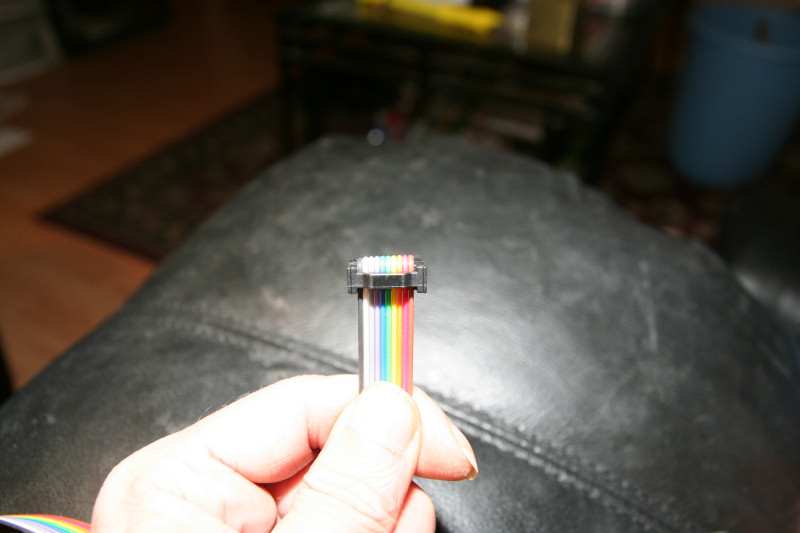

tonyn Posted December 13, 2009 Author Posted December 13, 2009 (edited) I thought I would show you the assembly of the IDC connectors to the ribbon cables. If you ordered from avishowtech.com you have the option of 10 pin female IDC or 5 pin crimp type. Version 5 Din boards(I have version 5) can use the IDC, so I choose the IDC since they are easier to assemble and cheaper, etc. If you ordered his 10 ribbon cable it is nicely colored too and starts with a brown and ends with a black colored wire. I used the brown for pin 1, and black for pin 10(so it can be color coded for the ground pin) If you use a plain grey ribbon cable, pin 1 is usually colored red. These are standard color type codes, so it's nice to try to have some standardization and consistancy. There are 3 parts to the IDC connectors. The bottom part has an arrow where pin one is to be. To be consistant this should be on top and on the right(but you can reverse it too if you want). The second part you put on first by slightly pushing it in to partly pierce and crimp the ribbon. It has ridges to aling the wires right, so they get pierced correctly. You can use your fingers for this part. Once the wires are slightly pierced, you can then insert into the vice and finish crimping it. If your vice has ridges, use a piece of sheet metal, etc., so you don't damage the connector. Center it in the vice and slowly finish crimping it together. The third piece is a strain relief and keeps the ribbon from pulling out. You insert that last, with your fingers. You can cut the ribbon with a scissors. Make sure it is at a good 90 degrees. As you can see, if you are to use the strain relief, you need to insert the ribbon cable from the other side, and bring back around. So plan accordingly. Yes, my vice is rusty, but so am I:) I had it in storage, but it works fine. If you don't have a vice, I suggest buying that instead of an expensive IDC crimpers. It can also be used for other things too. I am also a couch potato, so I like to work in the comfort of my living room if I can. Here's some pictures.. Edited December 13, 2009 by tonyn
