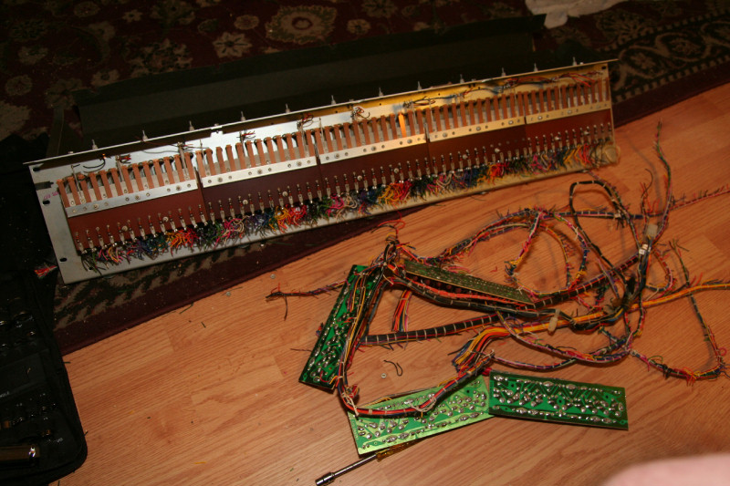

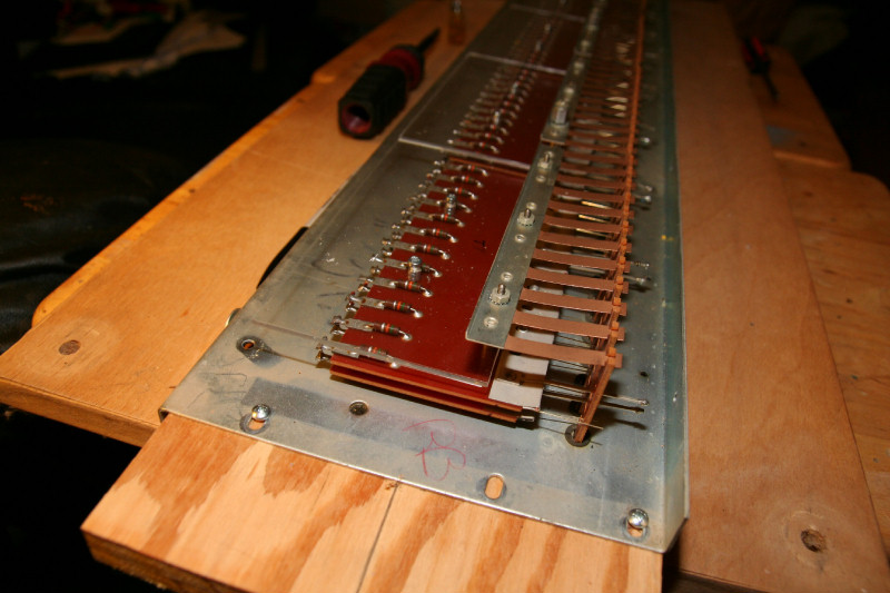

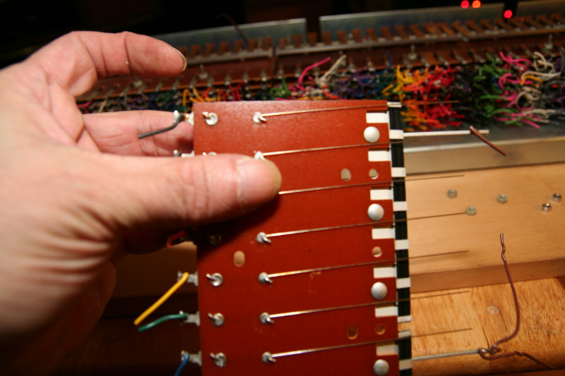

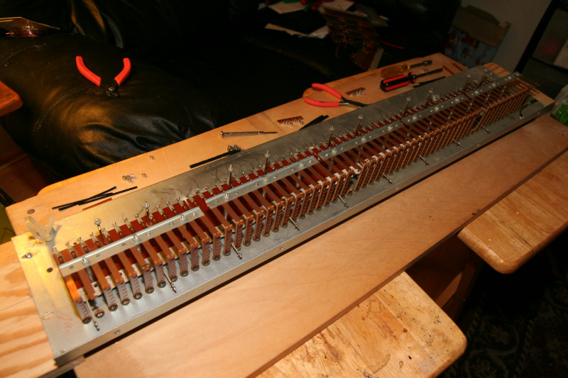

tonyn Posted December 23, 2009 Author Posted December 23, 2009 This was a hard decision for me! I am now commited to this! I can't go back now! I just cut the wiring harness for the old contact boards to the old electronics! Now I will gut them out of the old wires and electronics, and see what I need to do to wire them up to the Dins. Here's a picture from the top of one of the old contact boards.

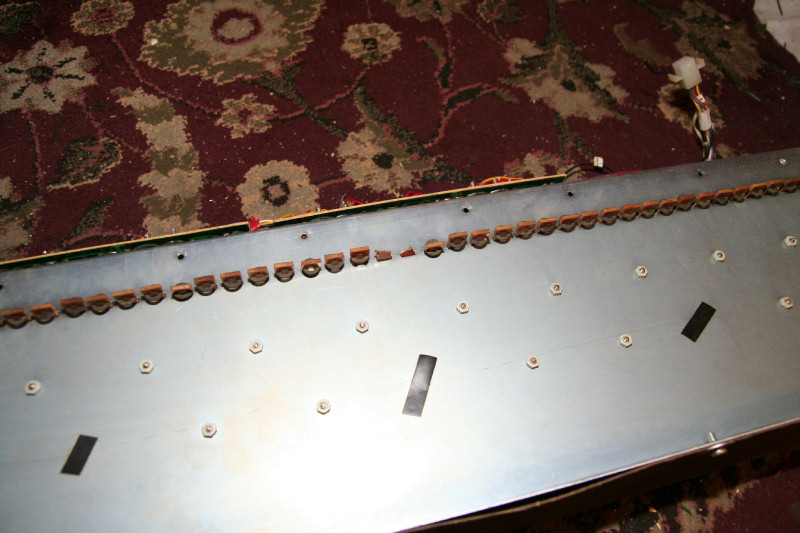

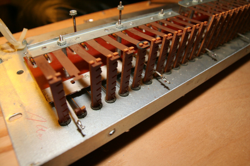

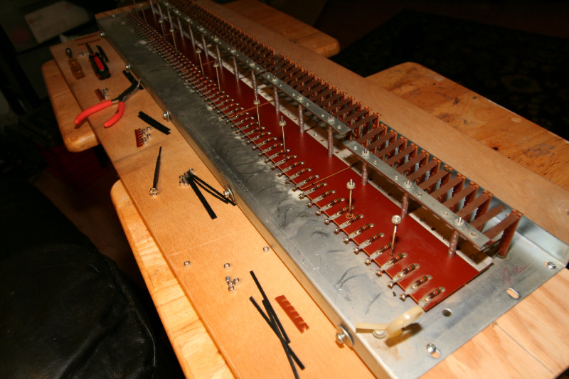

tonyn Posted December 23, 2009 Author Posted December 23, 2009 (edited) Damn! Be careful when removing old contact boards, if you want to re-use them, else you may end up with broken parts like I have. I must have damaged my old contact boards somehow when I took them out, etc. I will have to either make a couple of these or see if I can get some from my organ guy. These are fragle! Note: What I will do for the time being is(as I did when I had broken keys from a move), move the broken parts to keys of an octive that doesn't get played much (like the highest octive on the lower keyboard). These parts shouldn't be hard to make though. I just need to get my dremil and some circuit board material (seems like they are made out of that), and cut a few new ones. Or I could use acrylic, etc. On the bottom of a few, they are missing the rubber gromets. Those I should be able to match up at my hardware store. So it shouldn't be hard to replace them. But now I NEED TO BE CAREFUL WHEN WORKING WITH THESE CONTACT BOARDS, NOT TO DAMAGE ANY MORE! Edited December 23, 2009 by tonyn

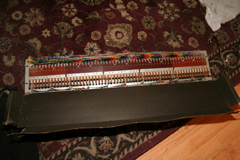

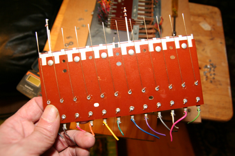

tonyn Posted December 23, 2009 Author Posted December 23, 2009 (edited) OK. I have one of the old contact boards completely stripped of the wire harnesses and electronics. That was a lot of wires to cut. I won't need all of those wires and I am commited to completely midifying these anyway. Plus I want to lighten up these boards by only having wires attached that I need to neaten it up, etc. Basically all that will be wired to them is the ribbon cables from the Dins. Plus by cutting all of the wires , if there was a matrix, it should be broken now (Unless I need to break some points on the circuit baords too, I'll see). I can now trace out the circuit boards to see what I need to do. Edited December 23, 2009 by tonyn

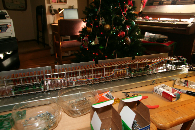

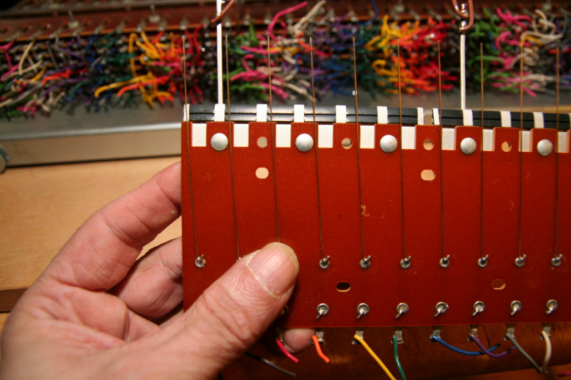

tonyn Posted December 23, 2009 Author Posted December 23, 2009 (edited) Well these contact circuit baords are simple! But interesting. They do have a common I can use for one side for my Din grounds. They do have resistors, but I'll bypass those. But there is a rubberized type of coating when they make contact that gives 5k ohm resistance, etc. That part is interesting. Should I leave it on or scrape it off? Let me take a look again at the Dins. Maybe I can leave that as is and remove the resistors from the Dins, etc.! Also: I only need one set of contact circuit boards. So to allow for mounting of the Dins and Core directly onto these boards I will have to remove some circuits down to the lower one, so I can mount the Dins and cores and have space between the keyboards. I'll just use spacers to the leaf springs which need to be on top. Edited December 23, 2009 by tonyn
tonyn Posted December 23, 2009 Author Posted December 23, 2009 (edited) Well that solved that. The rubberized part was actually 2 pairs of rubber strips that were crimped in on each side with metal tabs. So I just lifted the metal tabs that crimped them and pulled the rubber strips out. Now 0 resistance! So I'll just strip them out of the circuit boards I need. Now to remove the other boards down to one layer of circuit boards. To replace the space that was taken by the removed circuit boards, I'll use washers. There are also spacers that spaced the circuit boards. I can keep those. I do need the top leef spring parts to be the same height, so that means that I need to space it from the lower circuit boards. This space will allow me to mount the Dins and core in that area. This is looking like it will be easy to redo these old contact boards! Edited December 23, 2009 by tonyn

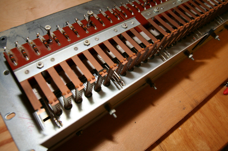

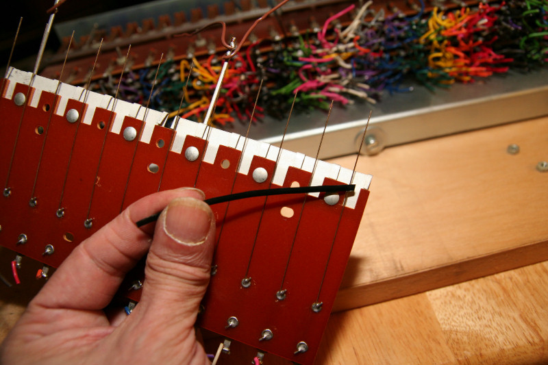

tonyn Posted December 23, 2009 Author Posted December 23, 2009 Well it wasn't quite that simple. After removing the rubber strips and remounting a circuit board, and pushing the tab to simulate a key press: It couldn't make contact with the metal part. THESE ARE PRESICE CONTACTS! So what I will need to do is find some metal to replace the rubber strips. I could bend the metal part down but I don't want to do that, since my bend may not be exact for all circuit boards. Humm, what to use???
tonyn Posted December 23, 2009 Author Posted December 23, 2009 I think I got it! I'll just solder strips of wire in to replace the rubber! But what gauge would work? I'll have to see..

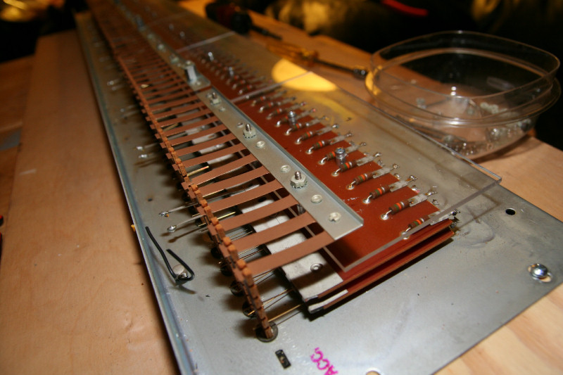

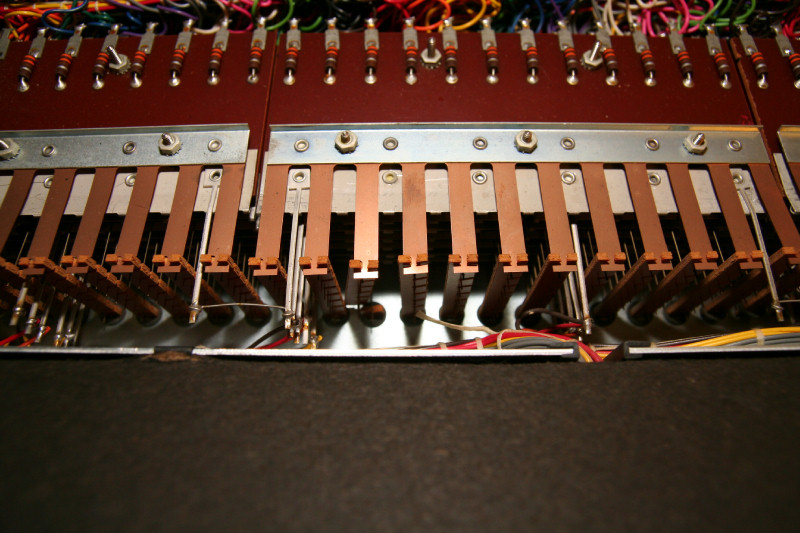

tonyn Posted December 23, 2009 Author Posted December 23, 2009 (edited) Works great! I used 18 gauge solid copper wire. I didn't solder it but just crimped it, for now. It makes good contact just like I want! As you can see I only need one layer of these circuit boards. Now to do this to the rest. After that it's just figuring out how to fit the Dins and core in. I didn't use washers since I had left over spacers, I used them instead to get the right height. The rear screws will be reduced to accomodate the Dins and core in that area. Edited December 23, 2009 by tonyn

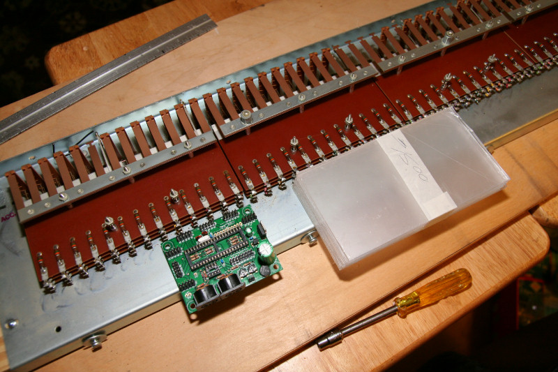

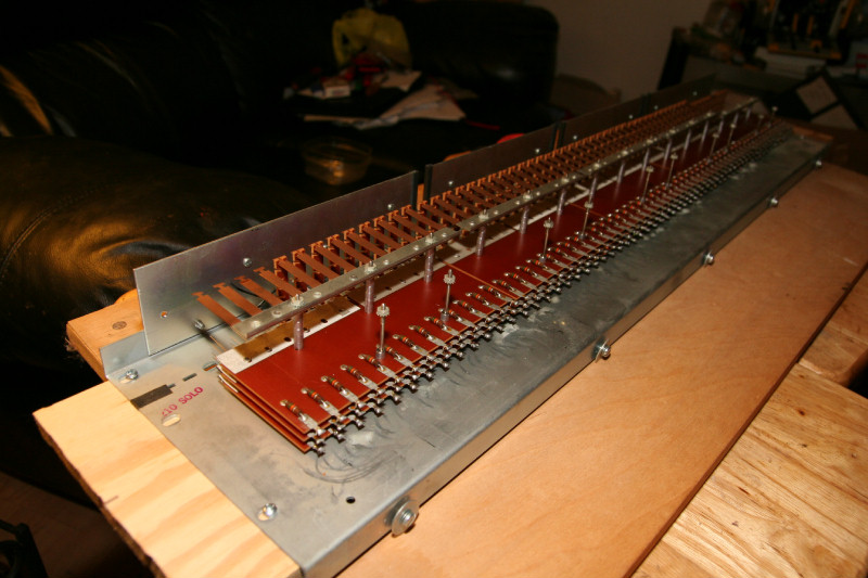

tonyn Posted December 24, 2009 Author Posted December 24, 2009 OK. All of the 18 gauge copper wire is crimped in on one contact board(i.e. the Solo, or top keyboard), and it is down to one layer of contact circuit boards. Now to figure out how to mount the Dins and core. This contact board had 5 broken tabs! I can move 4 to one end of the keyboard and one to the other. These tabs are 3/32 inch thick(as compared at hardware store to 3/32 inch acrylic). So I can make new ones out of 3/32 inch acrylic.
tonyn Posted December 24, 2009 Author Posted December 24, 2009 (edited) Taking a look at the stacks of contact circuit boards I stripped out that aren't needed: I am keeping them in case I may want more contact boards for something later. I would like to have second touch, but I need to figure out how to get it. When I figure out how to mount my Dins and cores in that area I'll compensate for a couple more contact boards just in case. I only need enough height so the Din and core circuit boards are not too high. I have about 2-3 inches max height for these contact boards before I run into trouble with clearance between keyboards, etc. Plus it WOULD be nice to figure out how to design a set of contact boards for second touch, etc.. So I'll mount the Dins and core so that they allow for more contact boards, etc. The tallest component is that 2200 cap on the core. I am also going to try to epoxy the broken tabs together. I do have all of the pieces, so if that work I'll be able to have a full keyboard for the solo. The other contact board has tabs that maybe beyond repair though. But that is the lower keyboard, which has areas that are not played much, so I can put the bad ones in those areas until I can either find good ones or make them. These tabs seem to be solid when in the contact boards, and don't get much preasure from key presses. So in the organ they are fine. It's just when you take out the contact boards they become vunerable to damage, so note this when you remove them. I also have my organ guy that may have some. Plus if I want to make better ones I would make them out of acrylic, which should have a longer life than the circuit board material those old tabs are made out of (they over the years may have dried out and became brittle, etc.). If I plan to replace ALL of them with acrylic ones: I WILL NOT MAKE THEM MYSELF! I do have this acrylic manufacture guy that can make precise parts like this out of acrylic. So I can see how much he would want to make all of them. As you can see in my setup I screwed the ends of the contact board to scrap pieces of 3/4 plywood to protect the tabs while I was working on it outside of the organ. When I wire up the Dins I will bypass those resistors(they aren't the right value anyway). I AM NOT removing them since they are attached to the contact wires and add to the alignment, integrety of the board, etc. If I try to remove or replace those resistors I may run into trouble with the contact wires, etc. Edited December 24, 2009 by tonyn
tonyn Posted December 24, 2009 Author Posted December 24, 2009 (edited) Second touch! I have an idea on how to get it! As you can see the contact boards have wires that make contact with the metal that is at a 45 degree angle. When I removed the rubber strips I had to replace that wth something to make contact. Those strips were there because the old electronics had a lot of current to those and those contacts drove gates. So the rubber added resistance. I haven't tested it out, but right now the keys, I think, make full contact when they are all of the way or mostly all of the way pressed down, thus the wire hits the top of the 45 degree angle and copper wire. But, by bending that metal, or moving the wire from front to back (good thing they are crimped so I can move them if needed), etc., I maybe able to get a contact with a keypress half way etc., and all of the way, etc. Thus first and second touch, etc.! But this would be a very precise adjustment. I have enough spare contact circuit board with which to experiment with. So I'll play with that later. But now I know I want at least 2-3 contact circuit boards installed: One for first touch, one for second, and a spare for something else. I still should have enough clearance. I'll need 2 more Dins for that too, but those are low profile (except for the IDC part, which can be changed later by removing the strain reliefs, etc., to allow 2 Dins to stack nicely on top of each other). See, I always think things out so that I cn allow for improvements, etc., later. Edited December 24, 2009 by tonyn
tonyn Posted December 24, 2009 Author Posted December 24, 2009 I also figured out how to mount the Dins and core: I will just cut some square pieces of 3/32 inch acylic, that will mount above the contact circuit boards(3 now as decided), drill some holes into the acrylic pieces that align with the lower contact circuit board screws, and mount them to that part. To those acylic pieces I will drill the 4 screw holes for the Dins and core, and mount them to the acrylic pieces using my nylon spacers and #6 machine screws and nuts. Simple. I shouldn't need to redo any ribbon cables that I used for my push button boards, etc., just remount on acrylic pieces. But this time the ribbon cable ends will be soldered to the contact circuit boards. I'll show you when I get to that part. But today is Christmas eve., so I may not be able to do that today. But at least it's all planned out now. It's just doing it that's all.

tonyn Posted December 25, 2009 Author Posted December 25, 2009 (edited) I just decided on the size of my acrylic pieces. I will make one per contact circuit board so that it is consistant, and each can be removed to easily work on it. They will be as wide as the contact circuit boards and as thick, but they will be deeper and run to 1 inch of the back of the assembly, to allow for the ribbon cables to route, but stay within the demensions of the assembly. I need to figure out the sizes ahead of time so that the day after Christmas, I will be ready for them, and can go to the hardware store to have them custom cut. This is 3/32 inch acrylic, which is hard to snap just right without cracking it, etc. So I'll leave that up to the hardware store to do. I will need 10 pieces, and they shouldn't be more than $1 ea. So it doesn't pay to try to snap them myself. I know this from experience! Anything under 1/4 inch of acrylic is hard to snap or cut(too flexible). 1/4 inch you cut(it's too hard to snap). But I have sucessfully snapped 1/4 inch with a deep enough grove(dremel guys, they are great tools) Well you can cut 3/32, but why bother when it's cheap enough to have custom done, plus it's too flexible with trying that too without getting cracks. Ace hardware does a good job, and if they crack any, you don't pay for them. I'll drill the holes though. I have worked with acrylic in my aquarium DIY stuff. I like glass for the aquariums and sumps, but acrylic for overflows, etc. I love acrylic where I can use it. It doesn't rust, dry out(well it can but many many years). It's easy to work with to make all kinds of stuff with. Plus it doesn't conduct electricity, which is good for where you don't want that. It will look neat too(just wait until you see my completed assembly). It would work great for the tabs too, since you want non conducting material for those since the contact wires go into their notches. There is a version of acrylic that is called plexiglass, which is more flexible, since some acrylic is brittle. The hardware store version, I think, is plexiglass. I do want that for the tabs(when or if I decide to change them over to acrylic). That is because the tabs have very narrow areas in the notches that if the material is brittle, they can break easy, just like with the old material of the tabs. I don't want that! The pieces that I'll mount the Dins and core to, can be flexible too(well 3/32 will be), since the screws will firm them up, as they do for the contact circuit boards, so the mount should be solid. Lexon is another version too(little harder to cemment I think though), I think is at Home Depot. I can get black or clear in either, just depends on what is easily available, etc. Edited December 25, 2009 by tonyn

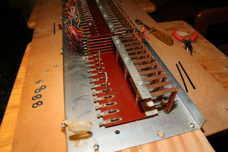

tonyn Posted December 25, 2009 Author Posted December 25, 2009 (edited) Sheu.. That was tedious work. It took me all night to just remount 2 more contact circuit boards back in. I had to figure out the number of spacers to use to get the right height. I had to carefully insert them so the contact wire springs nor tabs were damaged. Plus I had to put the wires back into the groves in the tabs. The boards with the crimped wires are on top for easy access. Plus if that is to be the second touch I want those boards last in the keypress (don't ask why, it just makes some sort of sense to me that the second touch should be last), which will be on top. Now this board is ready to add the acrylic pieces and mount and wire up the dins and core. I am also thinking out how to flip and rearrange the dins better now that I know how the core sees them, etc. Now this contact board will go into the organ temporarily to check on the contacts actually making good contact, and for feel (I am sure it's great since these boards were designed for the organ), before I continue any further. The organ is also the safest place for it to prevent damage while I work on the other contact board to strip it down. Here's a few pictures for you: Edited December 25, 2009 by tonyn
tonyn Posted December 25, 2009 Author Posted December 25, 2009 (edited) Now that is what I want! The key press is perfect, as intended with these old boards. I was also right in the fact that where I put the copper wire makes a difference on where it makes contact in the key press. Right now where I have the copper wire crimped at would be good for second touch(i.e. you have to press the keys all of the way to get contact). All I need to do on the organ side is adjust for height. I forgot what origionally was inserted between the board, a nut, a nut and a washer, or nothing. See I changed that when I mounted the wood boards in. I should have taken a picture to resort back to. But that is no problem I just need to play with those combinations until it's just right. At least the keys align with the contacts every other way without bending any metal. Now that that is confirmed I will continue with stripping the other board, and mounting and wiring up the dins and cores. Edited December 25, 2009 by tonyn
tonyn Posted December 26, 2009 Author Posted December 26, 2009 (edited) Damn! Looking at the old Accompanment contact board I have 8 broken tabs! So that is 5 from the Solo and 8 from the Accompanment keyboards. I can't swap between the keyboards the tabs, since the stacks of contact boards are different. So for the Solo I was able to move the broken ones to 4 on the top Octive and 1 on the lowest. For the Accompanment I have to do 4 on each end. That leaves the middle Octives all in tact. I have all of the broken pieces of the tabs for the Solo. So those I can try to epoxy and then I would have all of the Solo keys working. For the Accompanment I have all but 2 that can be fixed(2 are beyond repair). I will check with the hardware store tomarrow to get their opinion on what the best type of epoxy to use to repair them. If the tabs can be repaired, I will only have 2 keys on the Accompanment unplayable until I can replace 2 of those. I'll also check with my organ guy to see if he has any, if not I'll have to make them. All of these tabs could have been broken with my dissassembly of the organ, or maybe in a move. I have had this organ for 25 years, and it has been moved a lot, and carelessly a few times. A hard blow to a key may have damaged some tabs. But even with these broken tabs, I am still happier with the old contact boards than with my push button boards. Looking back at the push button design: They did have an OK feel(a bit stiff at the end of a keypress, but not too much), but required VERY precise alignment of the holes for the switch mounts, precise height adjustment(one thickness of a washer can make a big difference), and need to be mounted on a solid piece of metal vs wood(wood even with a slight warp is too much). I will see if I can use the push buttons somewhere else, and the terminals I can put to use somewhere. Edited December 26, 2009 by tonyn

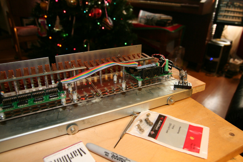

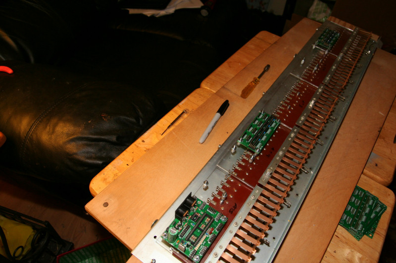

tonyn Posted December 27, 2009 Author Posted December 27, 2009 I figured out the placement of the dins and core, drilled the holes in the acrylic, and temporarily mounted them. I had to cut the resistors out to allow for the screw heads that ended up on top of a resistor. I also have mounts for 2 more dins for second touch! Both sets of dins are centered per 32 contacts as I did with the push button board. But this time I allowed for 4 dins. All I need to do is figure out the placement of the fuse holder, and power terminal(both mounted onto the metal part for better stability). As you can see, I flipped the Dins and Core so pin 1 in midibox will pin 1 on Din 1, etc. Now to do the Solo board, and then it's just wiring them up.
tonyn Posted December 27, 2009 Author Posted December 27, 2009 (edited) Note: It is important to think out how you are going to be able to easily disassemble or assemble things to do adjustments or repair, etc. The rear 2 screws Baldwin had them threaded on each end, and into the metal. This allowed them to stay put in the metal, but the nut on the bottom secured them more. Since there are spacers between the contact circuit boards, it helps to not have screw heads, so that you can mount the boards onto the spacers and then put nuts on top. I had to go to screws with heads, since the Dins mount over the tops of the screws and I didn't want anything touching the bottom of the circuit boards. But my way is a bit tricky to assemble, etc. Since you need to carefully insert the spacers btween the boards, then screw the screws in, and then add a nut on the bottom. I do want nylon spacers between the Dins and core circuit boards and acrylic. But you can't access the bottom of the acrylic pieces for the screw heads. For a couple of Dins I can premount them on the acrylic. But, sincee a couple of Dins mount to 2 acrylic pieces, I can't. So I had to change the mounts a bit by adding a nut under the spacers so that I can tighten the screws to the acrylic, add the spacers, then just pop the circuit boards on and add a nut on top. This added nut added 1/16" to the overall heights, but I have that to spare, barely. But at least it makes for assembly/disassembly easier. I also added nylon washers on top of the dins and core, just in case the nut may short a run that maybe too close to the holes. This doesn't add any height. I will also put a piece of electrical tape on the rear screw heads to make sure there are no shorts to the bottom of the din and core circuit boards, that mount over them. All of this extra hardware does add up. But, if you are to do something, do it right. Once I am done with my contact boards, I shouldn't have any worries later, if I do it right to start. Also: Before I took out the old stacks of contact circuit boards out I noted the heights to the tops of the leaf springs. Then when I added the acrylic pieces, etc., I figured out how many spacers(I was able to reuse the origional spacers, had enough) needed to bring the heights back to what it origionally was. This maintains the origional integrety of how it was designed. These contact boards were well designed for feel and to last. I wanted to keep that. Too much preasure on the tabs may wear them out, etc. These boards have lasted 40 years and are still good. I want to have another 40! Edited December 27, 2009 by tonyn
tonyn Posted December 27, 2009 Author Posted December 27, 2009 Here's a few pictures showing where I am at right now. As you can see this is the Solo board. I have pulled the working Dins and core off of the push button board now and will be mounting them onto this board now. I will be able to reuse my IDC cables , which works out nice. The dins are arranged for second touch, which will be the second set of dins. But I have the mounts for the first touch, which will be added later. Those dins will be configured in software for first touch for now. But the keypress will be all of the way for this, which is for secodn touch. I wanted to do second touch first for keypress since that is at the end of it. Making a first tocuh would be just crimping a copper wire in the other set of contacts back some. I found out that the #6 nuts have tight clearances on top of the dins and cores (in fact right by one of the midi sockets, there wasn't enough at all). So I may have to switch over to #4 hardware for that. I also found that those rear screws stripped the metal threads. So I'll just drill out the holes with 1/8" bit so they go through the holes. They will be tightened with nuts and lock washers on the bottom anyway. Next I will be running the ribbon cables and measuring from the dins to the contact boards and soldering them.
