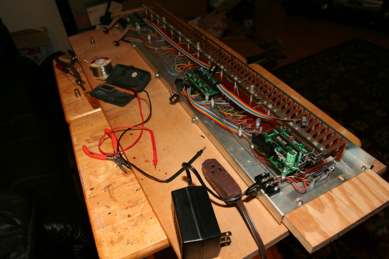

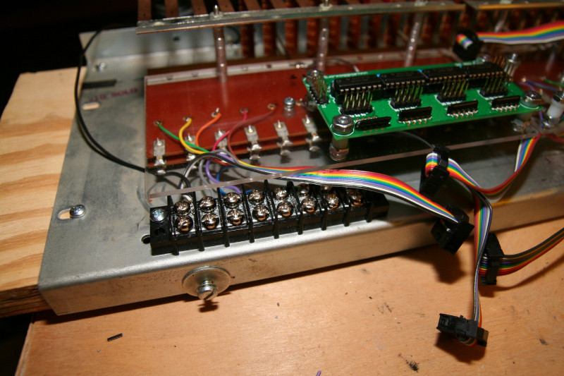

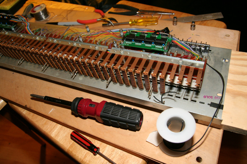

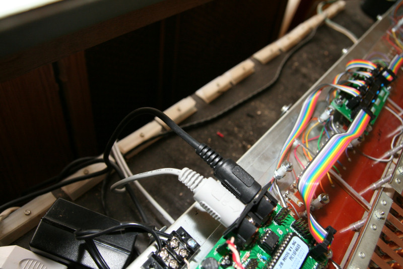

tonyn Posted December 28, 2009 Author Posted December 28, 2009 (edited) Sheu... I just finished wiring up the Solo board, and have a bunch of pictures for you! As you can see I mounted the power terminal and fuse holder to the metal part for security. Then I cut the lengths of ribbon cable for the longest length to the last point per din and cable. Instead of making all of my cables the same length, I then cut 5/8 inch off of each wire length from pin1 to pin 8. This allowed nice runs. The last 2 wires of the cables are no conection(white), and the ground(black). Knowing me, I didn't want any loose ends, so I soldered the ends of those together. I then soldered them to the ground buss on the contact boards. I continued from right to left. I was able to reuse ALL of the IDC cables I used without any waste from my push button board too! I was able to use those ribbon cables for the short lengths, and also made duplicate lengths for my Accompanment board. I moved from right(core board) to left(last din) only removing the plexiglass to get at the soldering for each set of boards. Then after putting the board back, I adjusted the contact wires in the tabs (a bit tricky, since those wires are like springs and have a tendacy to go to the right of that tab, so you need to carefully bring them around and put them into the slots). They are like spring steal so they stay in place and spring back. I then secured the rear screws on the bottom with lock washers and nuts. Then I used another terminal strip to connect the unused 3 left over inputs, and the last white and black wires from the second din (so I can get off board ground for those unused contacts). I can now securely run those off board to maybe some pistons. If I add second touch and 2 more dins I will have 6 spare inputs to use for pistons. Then I ran a ground wire from the ground on the terminal to the front of the contact circuit board ground busses, and also connected it to the metal to ground it all. This ground wire was all one piece too(I stripped it in the middle). Now I will mount this in my organ and power it up and see what I have. I will need to redo my midibox file, but now it will be nice and neat and orderly. The only problems I anticipate maybe the contacts not making good contact. But that only requires adjusting the copper wire. I know this type of thing works, since a Baldwin tech had replaced the rubber in a few boards with insulated 16 gauge?, wire. That insulation added the same kind of resistance as the rubber strips. I may need to go up to 16 gauge or move where I have it to the center more. I was able to get all of the #6 nuts onto the dins and core. I just used a smaller wrench. Everything is secured with lock washers too. Here's the pictures... Edited December 29, 2009 by tonyn

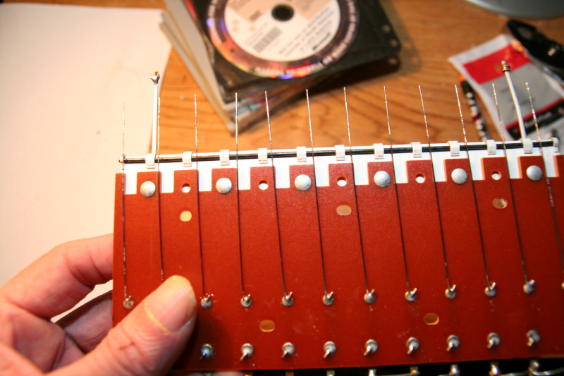

tonyn Posted December 28, 2009 Author Posted December 28, 2009 (edited) Yes my organ has percussion. I did find a few contact boards to have 16 gauge wires installed. But they were black, so I thought they were insulated. Some contact boards also had some carbon on the wires, etc. That may have come from high voltage with the old electronics. So I only used contact boards that had nice shinny wire, etc. But those boards with the wire already inserted may have been OK to use. They may have been for the percusion on my organ too. I only pulled out one board to test it to see what I had. So I didn't find those 16 gauge wire boards until I had already had my plans for the copper wire, and got to them(they were buried). By then it was too late anyway, for me. But my wire I have experience with now and maybe able to , by moving it, get 2 areas of a keypress to make contact, etc. The copper wire route seemed to be my only option. If you didn't have any rubber nor wire inserted those contacts may not make contact. Those metal busses are on a 45 degree angle, and with the rubber removed the contact spring wires can't touch the metal. So that was why I had to fill in that space with something conductive. Yours maybe bit different. But this is what I found with mine. Yes, I maybe farther along because I have been at it night and day for the last weeks! But I am going back to school soon and want to get as far as I can before I am heavily in study. I am chugging away at it daily. You can maybe just read my thread to see how I aproach other parts so you can get an idea before you atempt it with your organ too. This thread will grow to cover every bit of this from start to a completely midified organ. I also will be doign some carpentry work to repair the cabinet. so a bit of everything! Next on the agenda is the pedal board and swell pedal. I wonder what I'll find there? I hope you enjoy my long thread. I am trying to provide plenty of pictures so if people have simular organs they can see how it can be done. I am passing along a few tricks I have learned over the years for the unexperienced, so they know how to do it. I am also sharing my thoughts and trials and errors, to help others to avoid them. Feel free to share what you found with your organ too if you want. How far are you, and why are you too late? Hey, Tony, I think I found this thread too late, but I wanted to ask you if your organ had percussion. The reason I ask is that I own a Baldwin 214DR that has similar key contacts to yours. Wherever the contacts control stops, there is an elastomer pad with resistance. But, for the percussion controls, there is a silver rail that the wire touches. On my organ, there are two silver rails, the top one and the one beneath it. Beneath those are the elastomers. If there is the silver rail, there is no need to strip out the elastomer and put in a new wire. Just use the silver rail--it has zero resistance. On mine, I didn't even have to remove the contact boards. I just bypassed the resistors and used the existing wiring (it's color-coded by note for each octave). You are farther along than I am, but I thought I'd try to bring this up in case other people are working on Baldwins. Edited December 28, 2009 by tonyn

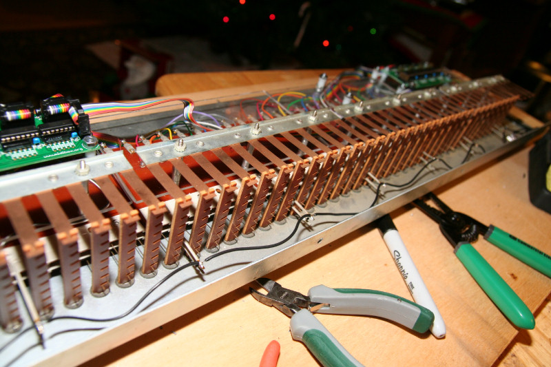

tonyn Posted December 28, 2009 Author Posted December 28, 2009 (edited) It works beautifully! I didn't have to adjust ANYTHING! The feel is fantastic too, just what I wanted! The keys play notes at just about the bottom of the keypress(tested in midi-ox output monitor) Or so it seems. I'll do better tests later. But hopefully this could be second touch (which the placement of my copper wire would be for the sets of contacts that are active now) But working on first and second touch is for much later... I need specs on first and second touch. Anyone? So soft, no stiffness at all(perfect in fact)! Every key that does not have a broken tab (the broken tabs are removed so that there are no shorts, etc.) plays even in Jorgan! Except they are out of place. I need to remap the keys in midibox. But they are all in good physical order now too(i.e. pin 1 on din 1 is key 1, etc.) for neat organized code! I didn't finish putting the old cover, etc., on the Solo board, just in case I had to remove it to adjust something, etc. But since I made sure everything would fit within the demensions of the old area, I should be able to enclose it easily with the old covers, etc. Now to finish the Accompanment. Edited December 28, 2009 by tonyn

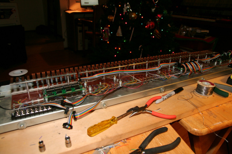

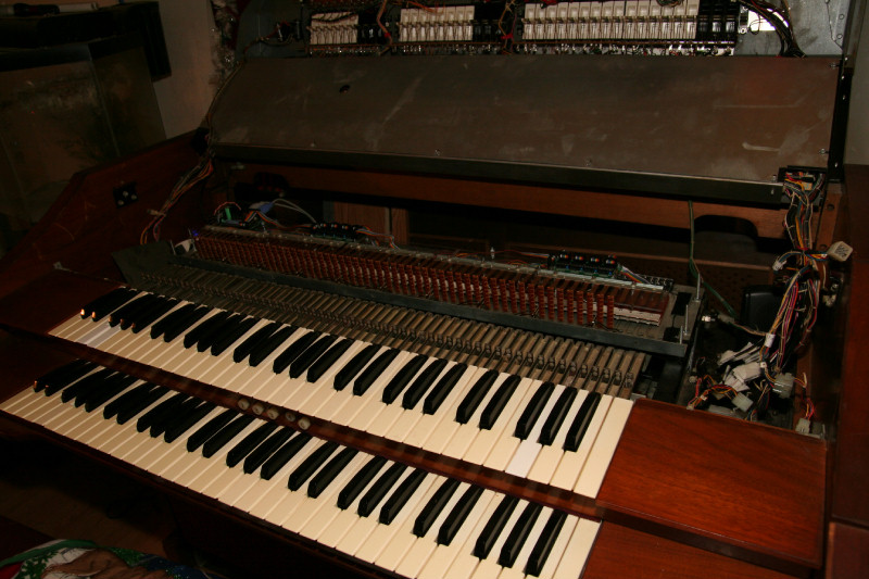

tonyn Posted December 28, 2009 Author Posted December 28, 2009 (edited) I am just about done with the keyboards guys(until I figure out second touch, much later)! The Accompanment is about the same as the Solo, so it should work fine too. Note: Plexiglass is brittle and can easily crack or fracture under too much preasure. I already knew this, so where I had metal to plexiglass(nuts, lock washrs, etc.), I did not tighten too tight. You have to have a feel for this to get it tight enough but not too tight. I also did not tighten too tight on the circuit boards either since they also can crack, etc. This comes with experience. I have years of it and know about how tight to tighten things. There is also the stress factor: Years of something being a bit too tight will eventually cause problems. This gos for wires, etc. So leave some play. But I am not done yet guys! This thread will grow to huge by the time I am done. I will cover every detail from start to a completely modernized midified computerized organ! I even have some carpentry work to do too. You will see me aproach EVERYTHING as I go. Next on the agenda is the pedal board and swell pedal. I wonder what I will find there? :blink: Don't forget the rest of my thread too. Go back and you may find some interesting thoughts, and trails and errors, that may help you in your thought processes and projects too. Edited December 28, 2009 by tonyn

tonyn Posted December 29, 2009 Author Posted December 29, 2009 (edited) After RVbottomly posted about his Baldwin having silver contacts, and that the percusion didn't have the resistive contact rubber: I decided to check out my boards I found that had a 16 gauges wire installed. I don't know wether it is copper or silver, or what. But it does have a black coating on it. I didn't find these boards until after I had initially found the rubberized boards and came up with the idea of the 18 gauge copper wire. It's nice to know that my thoughts were right on tract with what the Baldwin people thought of too. Except they put the wire in the middle, and I put it on top. But I am working on adding second touch, so I wanted the farthest that the key can go to make contact for second touch. The reasons that I wanted to get second touch first, was that all of the initial adjustments to get the farthest keypress makes for easy first touch to get a closer keypress by just inserting wires to the bottom, or middle, of the boards I want for first touch, wire up a second set of dins to them, and I am there. My wire placement and gauge does work for the farthest keypress as you saw a couple of posts back. Their wire is a little bit thicker than 18 gauge too(I assume 16 gauge, but haven't checked it out). But these boards DO have zero resistance if you clean the wire. Over the years or with high voltages, etc., these contacts on these board have like a carbon residue on them. Or they may have been meant to be resistive and were coated. I don't have the schematic on my organ, yet(I will get one though). But by scrapping the wire a bit I got zero resistance. As you can see this 16 gauge wire is in the middle. Through my tests this would be middle keypress. OK if you want only a one touch keyboard. Plus you would need to clean these boards if yours is like mine for good contacts. I just picked out the best boards with shinny wires and the rubber so I have good contacts, and inserted my 18 gauge instead. There are enough spare boards with the rubber that you can get the sets of 2, like I did, that match, so that you can make one for first touch, and the second for second touch. I still think that I went the right route, since with the 18 gauge you can have one wire on top for second touch and one either in the middle or bottom for first. They could optionally be tinned so the copper doesn't corode over time. The difference will be slight but can fit into the specs, maybe, of first and second touch. I did read somewhere that the specs say first touch and second touch should be 1/8" in difference in keypress. But is that from the top of the press or bottom? Anyone have specs on that? Anyway, here's a picture of a board that has a preinserted wire. As you can see there is carbon on the wires that needs to be cleaned off if you want good contacts. Edited December 29, 2009 by tonyn

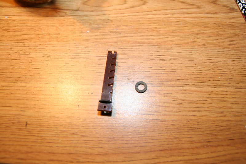

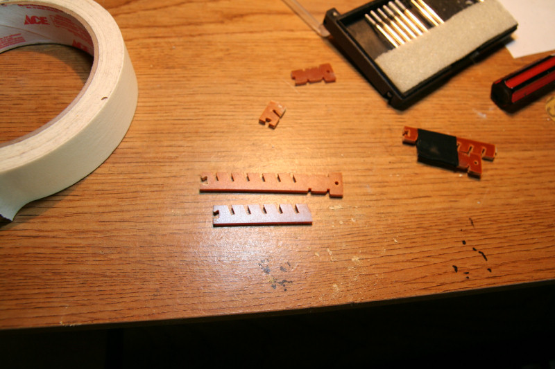

tonyn Posted December 29, 2009 Author Posted December 29, 2009 (edited) Just got back from my organ guy. He had ALL of the tabs I needed except the 6 layer one for the Solo. But he gave me a few extra longer ones and after we looked at them, I can use a dremel tool to cut a long one down to make a shorter one. While I was there we talked about how my organ was designed, etc. Yes, those contact boards with the preinstalled wires were for the percusion and had high voltage to them. The pedal boards have the same type of contact boards, etc. So that should be easy to do the same design with them. Except that I do not want the Dins and core down under the organ, so I will run wires up from the contact boards to where I will mount the dins and core. But, since the contact baords are the same, according to him, that means I could also do second touch for the pedals too! So I'll need to plan on another din! My midified Baldwin will have features that were not in the origional! He also said that the motor controller design of the leslie for my Baldwin was the good design! There are 2 motor controllers and 2 motors. One for slow speed and the second for fast. These are controlled by 1 stop(a 3rd stop turns the leslie motors on/off) So I now know what I need to control them. He will get me the schematic too so I can put back those motor speed control drivers. I also stopped by that organ store that had that Modernized lowery organ that inspried me to do this. That organ sells for $35,000! It has more stops and fuctions than you can count! It also has 16 speakers! At least that is what he said. I can't imagine how they cramed and why that many speakers in. It has a nice wrap around cherry console, but only 2 keyboards(I don't peticularly like the lowery keys, mine are sharp, their's are square), and a 25 pedal pedal board(short pedals, mine are full sized). That organ was origionally in the Pabst Theater. He said they are thinking of buying it back, unless someone else buys it first. Not me, that is too much! I am only looking at it for ideas. It has all push button type stop tabs with LEDs, that is what I need/want. My organ guy knows and will be looking at what he can get for me. He said I could buy them new too, but they may add up like my push buttons(122 for $130). I expect the stop types to be a lot more new! But they are also etched with the names of the instruments, etc. So I may have to order what I want, new. But I won't have the money for that part until Febuary anyway. Plus my organ guy will be looking for them too for me. He gets trades and parts from older organs in all of the time. He said who knows what he may have by Febuary. Who knows I may also design my own too! I already have 122 push buttons. All I need to do is design nice colored acrylic covers and put LEDs behind them. Damn! That's what I'll do! This way I can customize the stop tabs to replace, exactly, the old stop tabs and even use the old stop board! I found where they put the DVD drive and front panel card reader/USB, so that is where I will put those on my organ too. But it only has a 4x5 inch touch screen. I have a 15 inch! But I need to figure out how to mount mine so it is out of the way, but can move to where you want it. Right now it's on a cheap arm. Later I will get a better arm, etc. I also have to figure out where to put my keyboard and mouse, so they are out of the way, but accessable when needed. My computer power supply and guts will be mounted in the top part of the organ. I have ideas on where to put them too. Here is something that I also figured out: Powering off the computer from the main of the organ power switch? You DO NOT WANT TO JUST TURN OFF YOU COMPUTER, ESPESCIALLY IF IT'S RUNNING WINDOWS. Simple: I will install a UPS battery backup power strip (actually I will gut one I have and use the circuit board and battery, and wire up my own outlets, etc.) in the organ for the computer and electronics. This power strip will be powered on/off by the organ's main power switch. The UPS will have a plug as most do, that the computer can detect loss of power to the UPS with, and properly shut down the computer. Wahla! One power switch controls all! Plus a UPS is good to use even if you do not use the battery backup part, since it conditions line voltage too for sensitive electronics. The UPS strip will also be mounted inside of the organ. This is why it is important to me to design the midi circuits to not take up any additional organ space. I will need all I can use for this stuff too. Edited December 29, 2009 by tonyn
tonyn Posted December 29, 2009 Author Posted December 29, 2009 (edited) OK. I just replaced the top 4 tabs of the Solo keyboard. So now all keys play except for the lowest C, which needs a tab that I will dremel out for it. I was able to replace those tabs without removing the Solo board from the organ. It was tricky though and I had to remove the nuts and lock washers to lift it up slightly to insert from the bottom. The Accompanment I will do outside of the organ where I am working on it anyway wiring up the dins. A few tricks on these tabs you may want to know: Be careful of the top notch where the leaf spring gos into. If you remove or insert it wrong you can break the top notch. You tilt the leaf spring into the notch on one side and lower or lift it from the other. Also the rubber gromets need to be worked down the tab. Be careful with those too since over the years the rubber can dry out and they may tear. I had no problems, just wanted to pass this along. Here's a close-up picture of a tab and rubber gromet so you can see what I am talking about. The 2 bottom notches are for the gromets. The bottom one stops the tab from going up too far, and is inserted first. Then the tab gos into the the board, and the second from the bottom notch is for the second gromet which you work down the tab being careful on the notched side. On top is a trangular notch for the leaf spring. The other notches are for the contact spring wires. I use the bottom 2. Edited December 29, 2009 by tonyn

tonyn Posted December 30, 2009 Author Posted December 30, 2009 Sheu.. I finished wiring up the Accompanment baord last night as planned. It isn't hard, just tedious and takes time. Before I put the ICs in I electrically tested the Power adaptor, the dins, and core for voltages, etc. I tested these because I hadn't. for the Solo I did no electrical tests since the dins core and power adpator were already tested for the push button board. Then inserted the ICs, installed in organ, connected to computer and it worked. So I setup midibox128, reconfigured for channel 2 for this keyboard. But I had no keypresses! I tested for continuity with the contacts, etc. Then I decided to check out each din to the core. So I made a long IDC cable for testing. Connected from core to second din. Wahla I had keypresses. Connected from core to first din and the same. Put cable between dins back and used test cable from core to first din and everythign worked. My IDC cable from the core to the first din was bad. I also foudn that on this baord I did not have to move the cable between the dins to the right (I wanted to figure that one out). So the Solo baord's cable between the disn is bad, now I knwo. It's a good thing I have spare IDC connectors and enough cable. Now I need to adjust a few of the key hammers some and add some felt pieces to the ones that they came off of. Those felt pieces quiet the hammers when they hit the tabs, and also keep them from slipping off of the tabs. So it's important to have them all on. I think I'll try contact cemment to reattach them.

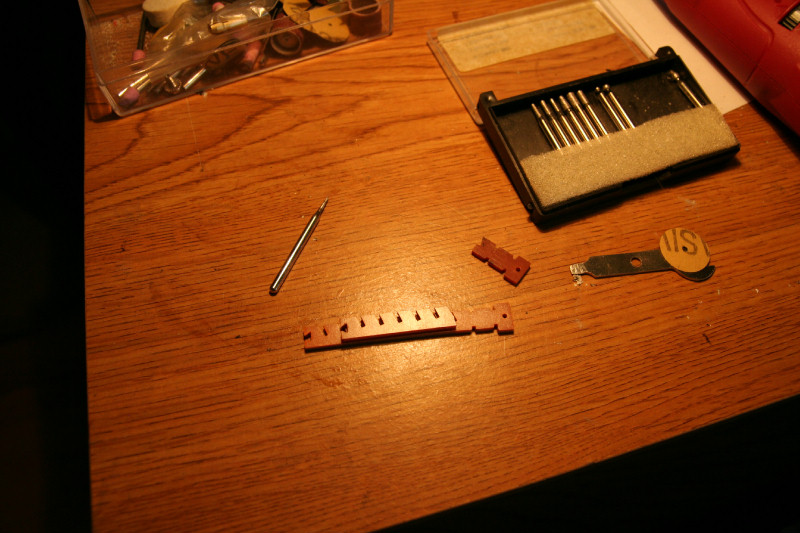

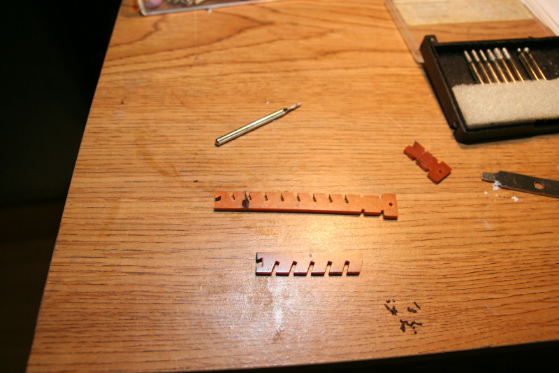

tonyn Posted December 31, 2009 Author Posted December 31, 2009 (edited) Great! I dremeled out a new tab for the lowest C of the Solo and it works perfectly! Now ALL keys from both keyboards work. I am just about done with the keyboards now, just a couple more things and I'll be investigating the pedalboard next. Here are some good close-up pictures to show you what I had to do. I had to cut off a tab from a longer one, and make the top trianglar notch. Not too hard. I cut the end off with my cuttter disk. Then I used a diamond glass bit to grind out the notch. These tabs are made out of an epoxy type material, like circuit boards, so they take a bit of grinding. But if you are careful it is easy. Edited December 31, 2009 by tonyn
