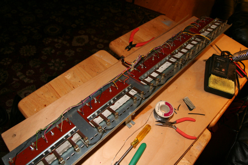

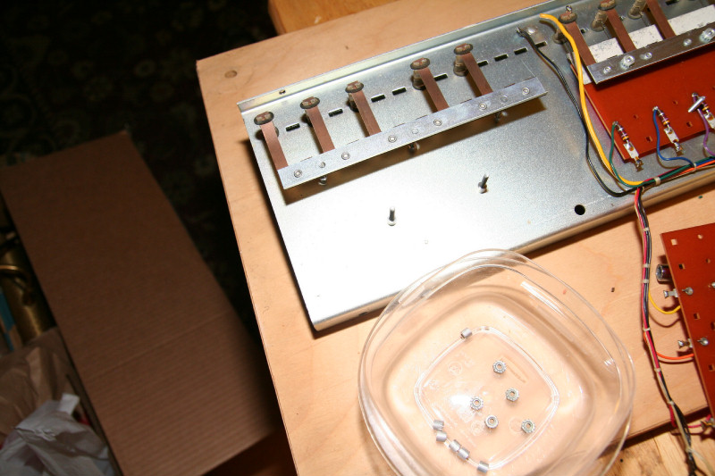

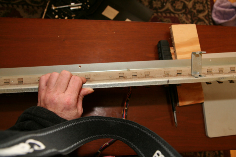

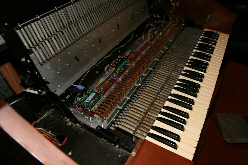

tonyn Posted January 2, 2010 Author Report Posted January 2, 2010 (edited) OK, new day new year... I just finished installing the metal plates onto the fronts of the contact boards. These plates had old circuit boards attached to them. So they could also be used for another core/din circuit(i.e. second touch). I then installed the old cardboard dust covers to reuse them. As you can see the core/din circuits fit nicely under them! I have to make cutouts in the backs for the inputs and outputs of power and midi, but that can wait until later. I am calling it done with the keyboards now so I can move on to the pedalboard and swell. My next posts will be on the pedalboard and swell! Here's some pictures of the completed keyboard contact boards: Edited January 2, 2010 by tonyn

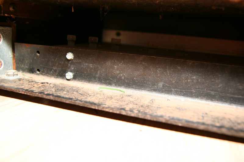

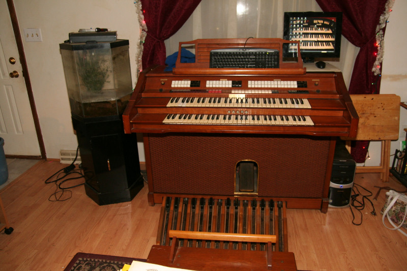

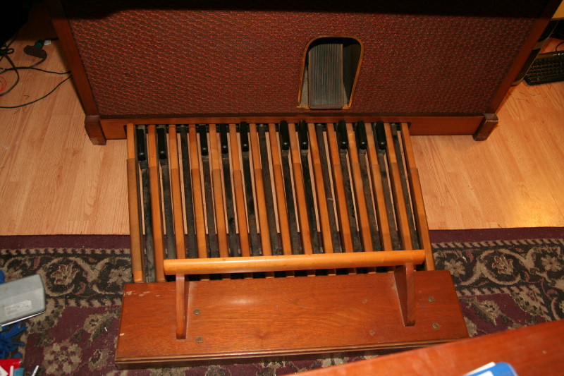

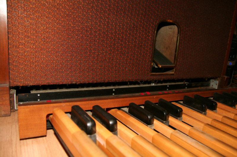

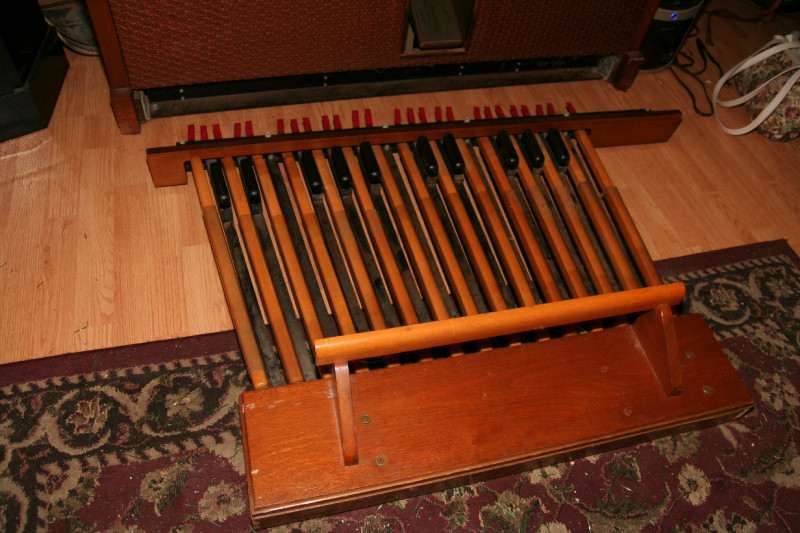

tonyn Posted January 2, 2010 Author Report Posted January 2, 2010 (edited) Yes, my organ has a nice full length pedalboard! As you can see it is ony 25 pedals but full length, but.. It looks like there is room for 7 more to make it 32! I'll see what the contact board looks like. Maybe there are 32 sets of contact circuit boards, and this organ had an optional pedalboard! I'll check with my organ guy on that too. The pedalbaord is also is removable which is nice. In case you are wondering about the fish tank: I have a fish that just won't die! He hasn't been fed in over a year, no filtration is running, no lights, the tank has not had water added, etc. I am just wating for him to die so I can clean it out. But he just won't die, and I can't deliberately kill him. My organ also had 2 front legs that I removed that am considering wether to put back or not. They don't seem to help with support. My cat has also been working against me with repair! She is sratching the tops of the legs of my bench! So I have some carpentry work to do too. Edited January 2, 2010 by tonyn

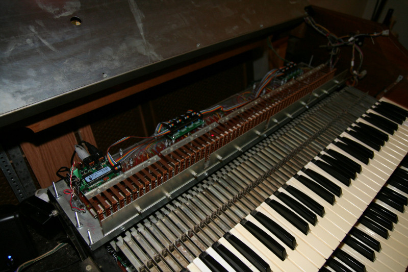

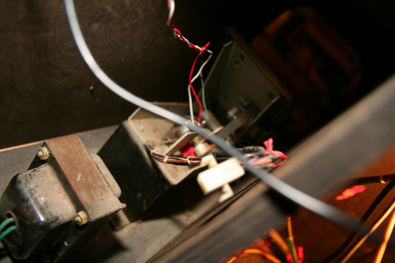

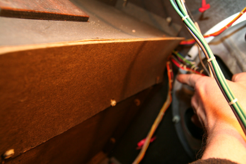

tonyn Posted January 2, 2010 Author Report Posted January 2, 2010 (edited) The nice thing about having a camera , is not only to document things, but it allows me to take pictures in tight spaces that I can't get into to see what's what. Before I atempt to remove the pedalboard contact board, I need to look at the cabling to make sure it is loosened from any tie downs, etc. To get an idea I took a picture first. As you can see, that cable that gos into the hole, must be for the pedalboard. But it might also be for a transformer or something for a leslie motor. I did have this organ mostly dissassembled last summer when I moved it, and saw something like a transformer under it. I won't really know until I get behind the organ. I might as well remove the amp while I am at it so I can work on it too outside of the organ. Yes I was doing some work on the organ before I decided to midify it, as you can see by the stripped wires. So now to move the organ away from the window to get behind it to work. Edited January 2, 2010 by tonyn

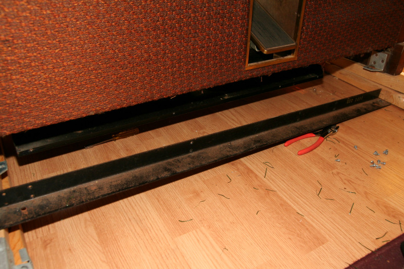

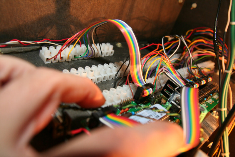

tonyn Posted January 2, 2010 Author Report Posted January 2, 2010 (edited) OK. I was correct. That is the cable for the pedalboard contacts. It gos up to old electronics for the pedalboard. So I will cut the wires for those electronics, and remove those electronics. I also took a look at the swell pedal and it just has a pot. Good I'll just replace that with a linear 10k, and wire it to the core. I will have to figure out how to pick up the analog of the PIC on the core, and how to code it in midibox. I will also have to add a header strip for that on the core of the pedalboard. I also looked at the amp and the circuitry looks simple, I can see the channels. So it may not be to hard to add premamps to it, etc. Edited January 2, 2010 by tonyn

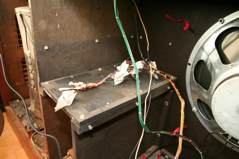

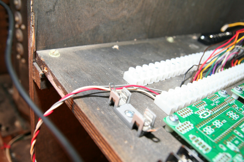

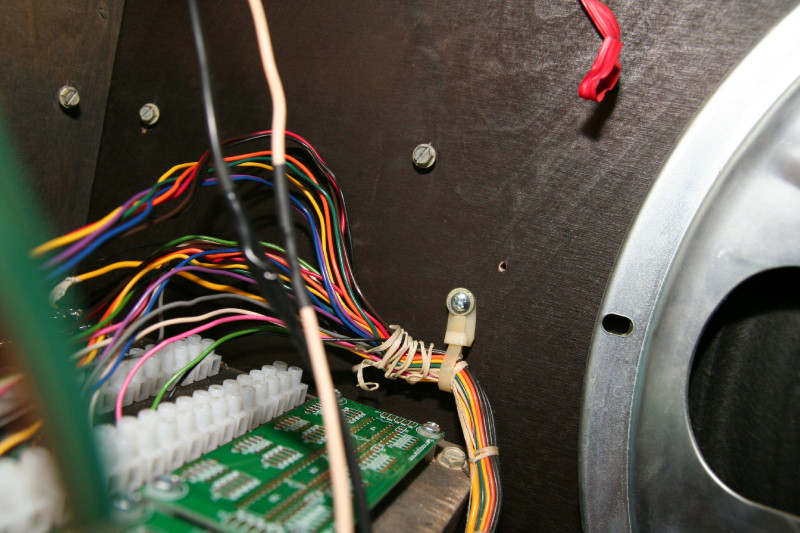

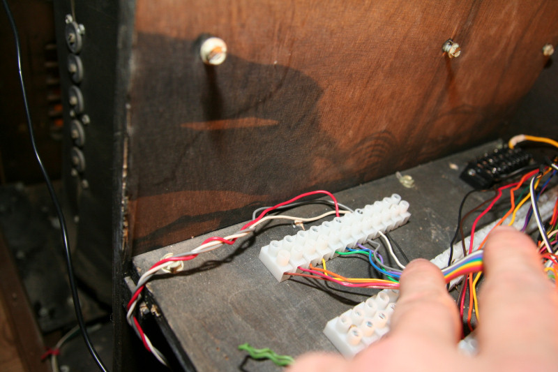

tonyn Posted January 2, 2010 Author Report Posted January 2, 2010 I think I found a new place for the pedalboard core and din circuit now too. I'll just use the spot where the old pedalboard electronics were! That way I can still use the wires that go down to the pedalboard contact board, and just solder it up to the dins there. As you saw there is also a nice(well so so) old dust cover I can reuse too. That way I can use the space in the upper part of the organ, where I was going to install the core and din for the pedalboard, for power strips, etc. BTW I am saving my old electronics(I never know what I may want/need to use). That is why I am noting what gos where before I tear any old electronics out. I may try to find the rythm circuits and wire them up to take signals from the computer, etc. I DO know I want to keep the leslie motor drivers, etc. I just need to trace the wiring out to that. Plus the main power switch of the organ lights up lights to the sheet music holder, etc. Those could be replaced with LEDs though. Plus I'll see what I can do with the old amp too. It may need to replace the caps, etc., and it will take a bit of work to reuse. I will be using my organ guy's electronics knowledge on that, along with looking at the origional schematics of the organ. But it would be cheaper than buying new amps, etc.
tonyn Posted January 2, 2010 Author Report Posted January 2, 2010 Well that wasn't too hard. I had to prop my organ up a bit to see what I was dealing with. The contact board also looks like they used acrylic for the tabs. There is only one stack of contact circuit boards, so I can't get velocity from the pedalboard. But who needs it there anyway? The wiring will be simple too, just bypass those resistors, and replace or clean the 16 gauge wire on the contact circuit boards, just put it back and wire up to the din. I'll have to solder a din and core circuit board too, since I only soldered the keyboard ones. I also took a picture of a leslie motor so get an idea as to what I am dealing with there too.
tonyn Posted January 2, 2010 Author Report Posted January 2, 2010 Hummm.. Interesting! These pedalboard contact circuit boards are the same as the keyboards! It's just that they do not use all of the contacts that the keyboard contact circuit boards do. So, I could swap out with the spares from the keybaords, just cut off the unused contacts. Plus: These tabs have 2 notches! Which means I COULD add another stack to actually have velocity! But that could be an added feature if I think the pedalboard needs it or not.

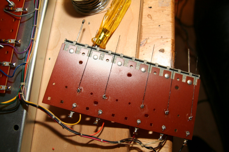

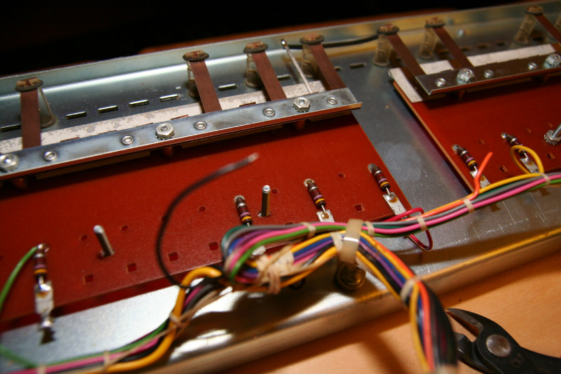

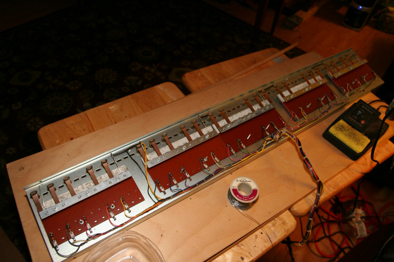

tonyn Posted January 3, 2010 Author Report Posted January 3, 2010 (edited) OK, that part worked out well.. I just bypassed the resistors. I used the old wires, just cut them close to the connections(to have as much length as possible), stripped just a bit off the ends(all you need is about 1/16"), and reattached them to the other side of the resistors. I used a simular technic for soldering the ends for the keyboards. The pedalboard contact board will be a lot easier than the keyboards, since I am using the existing wiring to run up to the din/core, and I am not adding anything to them. Now to remove the contact circuit boards, clean the contacts with some emery cloth, and insert a new copper wire in. I'll check gauges when I remove the old wires(I have both 18 and 16 gauge, whichever works best). The pedalboard is a piece of cake compaired to the keyboards. So this should go quickly for me. Edited January 3, 2010 by tonyn
tonyn Posted January 3, 2010 Author Report Posted January 3, 2010 (edited) I decided to keep the old silver wires (yes they are silver, or something other than copper, and 16 gauge). But I did remove them and sand the carbon residue off of them and put them back in. I also had to sand the carbon off of the spring contact wires too. This I had to do carefully not to bend them. Now I have good continuity. I also cut the ground wires off of the front buss so I can do one board at a time. I'll put new ground wires in after all circuit boards are back. The yellow and black will be connected together and grounded to the metal of the contact board. 4 more to go.. Edited January 3, 2010 by tonyn

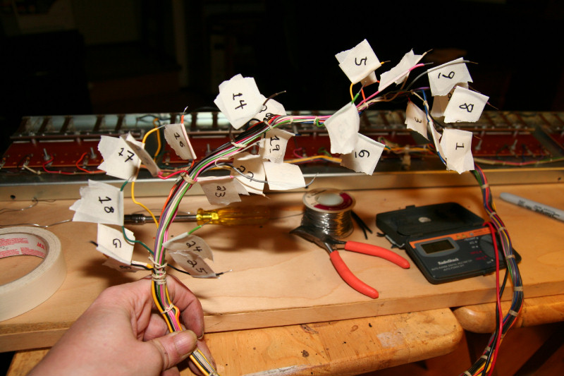

tonyn Posted January 3, 2010 Author Report Posted January 3, 2010 The pedal contact board is all ready to reinstall! As you can see I marked the wires so I know where they go when I put the cable back in. I numbered them from 1-25 upscale. That way I'll also wire them to the din in that order too.
tonyn Posted January 3, 2010 Author Report Posted January 3, 2010 (edited) Note: The contact spring wires ARE NOT attached to the through holes. So when I soldered a few of the circuit board of the pedalboard, from the top side, the spring contact wires pushed through, and came loose, and I had push them back resoldering. I didn't look at the keyboards, since I didn't remove the circuit cards, after soldering to the din cables. So this is something I should check later. If I were to do it again I would tape the contact spring wires in place before I top solder. You also want to point the spring wires slightly to the right or the non notched side of the tabs, so they spring into the notches and stay put. This is good to know too since I will keep my spare contact circuit boards from the let overs from the keyboards. I can make pedalbaord contact circuit boards by just removing the unused spring wires. They use the same 12 contact circuit boards that the keyboards use. But only 5 are used. So as I discovered velocity could be added to the pedalboard too by using spares from the keyboards and removing the unused spring wires. I can also replace any bad spring wires if needed too. The pedalboard contact baord has been reinstalled. Today I will put terminals strips into that area where I decided to put the pedalboard din/core circuit. I will connect the wires from the contact board of the pedalboard to terminals. Edited January 3, 2010 by tonyn

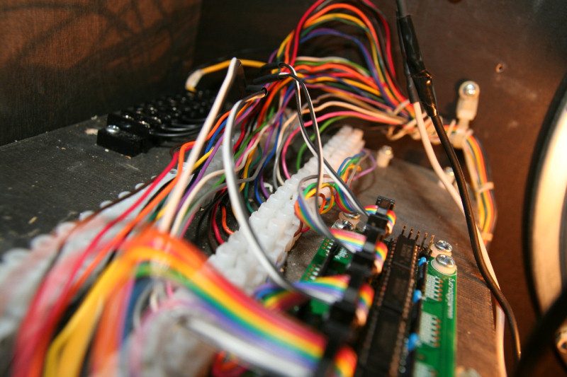

tonyn Posted January 4, 2010 Author Report Posted January 4, 2010 (edited) I took a day to thoroughly think out my layout for the core/din layout mounts for the pedalboard. I reversed it because: 1. I did not want to cut any more of of the wire lengths to the pedalboard than nessary. The way the ends of the cable ended for the old cable was that number 1 was the longest, and it was cut down from there. 2. I wanted to move the core a bit away from the speaker so it didn't interfear with noise, etc. 3. I have easy access to the core this way and fuse holder to solder, replace fuses, etc. 4. I moved the ground barrier strip to the other side since it makes more sense to run the ground wires over the terminal strip to the ground strip. I may also wire the fuse to the common or ground side, instead of the hot side as I did with the keyboards. The reason for this that was an afterthought, was that if you inadvertingly touch the fuse holder, being fused to the ground side you will not short anything or get shocked(unless you are also touching a hot side too). Safety! But I like to live dangeriously, and, to be consistant with the keyboards, I'll just fuse the hot side for the pedalboard too. :pirate: OK now to wire up the terminals, and install the mounts... Edited January 4, 2010 by tonyn

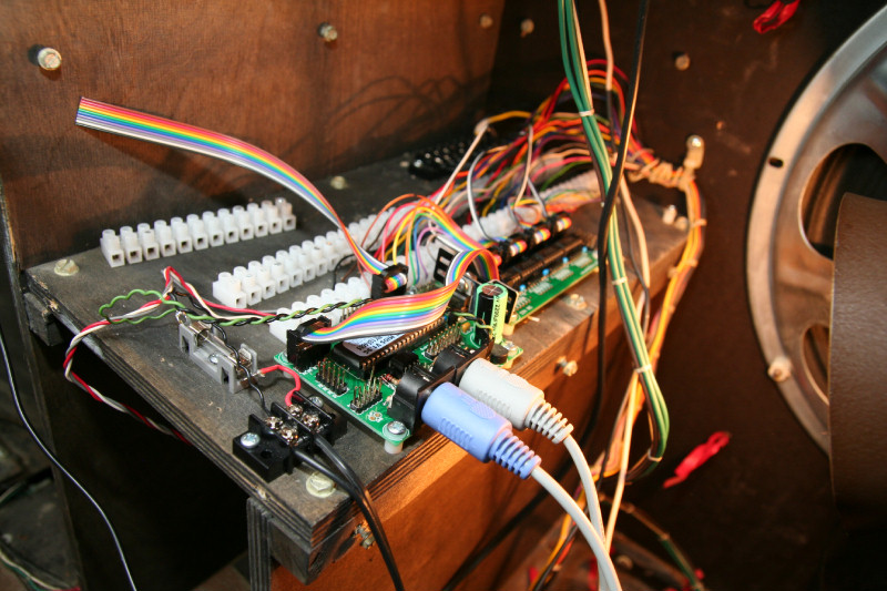

tonyn Posted January 4, 2010 Author Report Posted January 4, 2010 (edited) OK. The terminals are wired up to the pedalboard contacts, the swell is wired up, and everything is laid out and the mounts are in. I ended up cutting about 3 inches off of the length to get a good run for the terminals. In doing so my pedalboard cable barely reached. So I added a strain relief for the cable so it doesn't pull the wires out of the terminals, and I have a bit of play. I ended up installing the ground terminal barrier strip on the other side to catch the ground wires from the pedalboard. There are 2 grounds I ran up from the pedalboard contacts, a yellow 18 gauge, and a black 22 gauge. The more grounds the less resitance to ground, so it doesn't hurt to do more grounds than you need. The swell pedal pot I wired 3 22 gauge wires to it. I color coded them for grey and white on each end of the pot, and the wiper is red. Then I checked the resistance as the pedal moves, and on one end it's 10k, the other 5k. I took note. This was a bit dificult to solder in place, took a bit of cordination. I just tacked on the wires, and left the old cable, until I decide if I want to use it or not, etc. I then checked the terminals for the wires from the pedalboard to ground, to make sure no contact was shorted to ground. The next step required someone else to help. My son just came home from school so this was a good job for him to help me with. While I checked the terminals, I had him push the pedalboard contact tabs one by one to make sure I had contact. All work except pedal #2, so I'll have to look at that later. It maybe the terminal connection, or a contact spring wire. The contact board can be somewhat worked on in place. Moving a contact spring shouldn't be hard, if that is what it is(I hope that is all it is). Now to remove the din and core circuit boards and solder 1 din board (I only need 1 din for the pedalboard, although I planned for 2), and one core board. I'll also take a look where I am going to pick up an analog from the PIC. I may have to add some sin(single in line) headers. Avishowtech didn't provide any sin headers for the analog, so I will have to see... Here' a bunch of pictures for you. Edited January 4, 2010 by tonyn

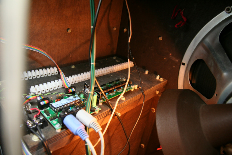

tonyn Posted January 5, 2010 Author Report Posted January 5, 2010 (edited) Last night I soldered up the din and core. Wired them all up and downloaded midibox to it. The core and din work, but I found out I had the din in the wrong place! Guess that is what happens when you are exhausted and not thinking steight. I planned the wiring to be nice and neat, but planned on the wrong jumper from the din to the core! So now I need to remake the IDC cables, and rewire the din and put it in the right place. I do have enough extra 10 wire ribbon cable to spare. But I am using the IDC connectors up fast. I did plan on extras, but I am exhausting them. This requires 5 more IDC conenctors! Haste makes waste! I am in a bit of a rush to at least have the keyboards, pedalboard, and swell workig by the end of the week, since I need to think about school shortly, and want to at least have that part done before I get into my schooling. I'll post pictures when it's all working and wired up correctly. In the meantime I am still trying to find the midibox128.ini code for volume, or for analog input, along with channel code for it. I found out that I can wire the swell pot to the +5v and ground, and the wiper to A0 on the core. At least another guy did that and it worked. But he had to hardcode it in hex. He couldn't find the midibox128.ini code either. I don't want to delve into hex coding just yet. At this point I just want plug and play with the ini files and syx. Anyone? Edited January 5, 2010 by tonyn

tonyn Posted January 6, 2010 Author Report Posted January 6, 2010 (edited) OK everything is wired up for the pedalboard and working in Miditizer and Jorgan! I was able to reuse all of the IDC cables I initially cut for my goof up. So no IDC cables were wasted. Except that the last set of wires to the Din are a bit tight. But they are to non used pedals anyway, and I can always easily replace the IDC cable later if I want. I still have the issue with pedal #2 though. Its not in the Din or terminal connections, so it must be in the pedalboard contact board. Hopefully it's just the spring contact wire out of place. So I'll get the pedalboard fully working next, and then move on to getting the swell pedal working. As you can see I have an IDC ribbon cable attached to J5A of the core to pick up what I need for the swell pedal. Knowing me, I didn't want any loose connections, so I'll run that ribbon cable to another terminal strip and from there just wire up the 3 wires from the swell pot. Here's my MIDI_OUT part of my midibox128.ini file for the pedalboard part. It's mapped to channel 14, since 15 maybe for a second set of contacts for velocity, and 16 for second touch. I also have 32 notes although only 25 are used, but I am ready for expanding the pedalbaord to 32, if I can. [MIDI_OUT] ########################################## # This is J3 on Din #1 # # Pin # On Evnt # Off Evnt # Behaviour # ########################################## 1 = 9D 24 7F 9D 24 00 @OnOff 2 = 9D 25 7F 9D 25 00 @OnOff 3 = 9D 26 7F 9D 26 00 @OnOff 4 = 9D 27 7F 9D 27 00 @OnOff 5 = 9D 28 7F 9D 28 00 @OnOff 6 = 9D 29 7F 9D 29 00 @OnOff 7 = 9D 2A 7F 9D 2A 00 @OnOff 8 = 9D 2B 7F 9D 2B 00 @OnOff ########################################## # This is J4 on Din #1 # # Pin # On Evnt # Off Evnt # Behaviour # ########################################## 9 = 9D 2C 7F 9D 2C 00 @OnOff 10 = 9D 2D 7F 9D 2D 00 @OnOff 11 = 9D 2E 7F 9D 2E 00 @OnOff 12 = 9D 2F 7F 9D 2F 00 @OnOff 13 = 9D 30 7F 9D 30 00 @OnOff 14 = 9D 31 7F 9D 31 00 @OnOff 15 = 9D 32 7F 9D 32 00 @OnOff 16 = 9D 33 7F 9D 33 00 @OnOff ########################################## # This is J5 on Din #1 # # Pin # On Evnt # Off Evnt # Behaviour # ########################################## 17 = 9D 34 7F 9D 34 00 @OnOff 18 = 9D 35 7F 9D 35 00 @OnOff 19 = 9D 36 7F 9D 36 00 @OnOff 20 = 9D 37 7F 9D 37 00 @OnOff 21 = 9D 38 7F 9D 38 00 @OnOff 22 = 9D 39 7F 9D 39 00 @OnOff 23 = 9D 3A 7F 9D 3A 00 @OnOff 24 = 9D 3B 7F 9D 3B 00 @OnOff ########################################## # This is J6 on Din #1 # # Pin # On Evnt # Off Evnt # Behaviour # ########################################## 25 = 9D 3C 7F 9D 3C 00 @OnOff 26 = 9D 3D 7F 9D 3D 00 @OnOff 27 = 9D 3E 7F 9D 3E 00 @OnOff 28 = 9D 3F 7F 9D 3F 00 @OnOff 29 = 9D 40 7F 9D 40 00 @OnOff 30 = 9D 41 7F 9D 41 00 @OnOff 31 = 9D 42 7F 9D 42 00 @OnOff 32 = 9D 43 7F 9D 43 00 @OnOff Edited January 6, 2010 by tonyn
