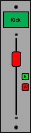

What do you think?   Thanks in advance for any input!!    I attached a picture of what I would like my fader panel to look like.   Ideally I would like the LCD to be a pushbutton relay sender for analog mute, and the automation read/write buttons to work locally on the assigned channel, and I will have a "shift" button in the center section that would cause any read/write button to change the global status.
