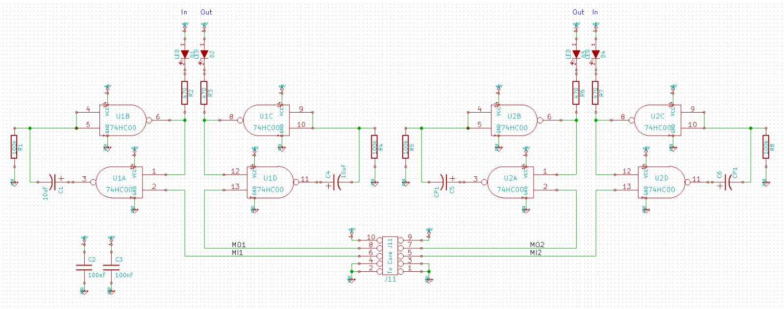

lylehaze 1 Posted July 20, 2012 Report This circuit will operate the NAND gates outside of the input voltage range.Each of the 4 gates on the top half of the drawing will be driven with a negative voltage spike each time the LED is turned OFF.How long it lasts will be a matter of chance and luck.
