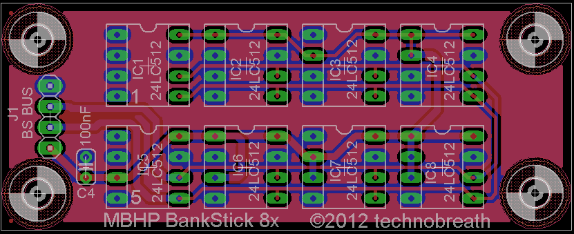

I just saw a thread on bankstick in the forum. thought I should post this. I made it a while back, and it has sort of been sitting in my eagle project folder since then. If anyone want the files, just send me a PM :).

It doens't seem much smaller as the pcb i got from Mike's shop a couple of years ago.
The only thing is, that it is a one sided pcb. Yours seems to be two sides :wink:

Yeah :). I havent seen any of mikes stuff. I didnt aim for a single sided board from the start. It was part of another more complicated PCB I made with 2xDIN / 1xDOUT / 8xBS on the same board :). So I just thought I should offer this part of it, since there didnt seem to be a lot of alternatives - I didnt want to retetris it to single sided when it was already done :).
