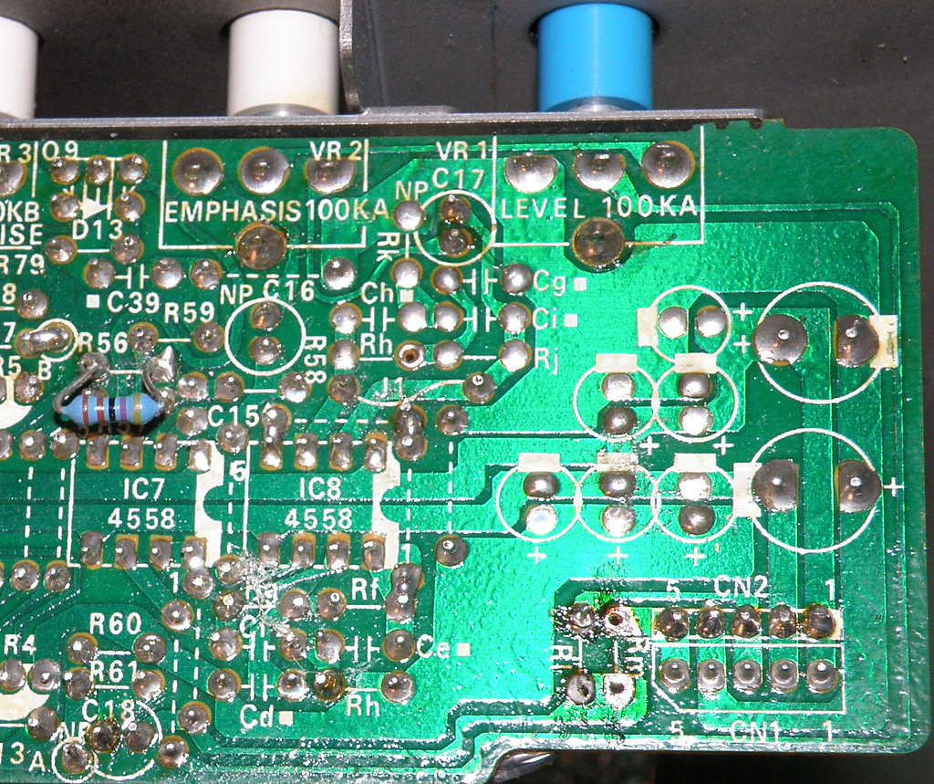

if you just need 1 channel, it is a good idea, to remove follwing resistors to reduce Humming(alot):
TomModule: Rm
ClapModule: R360
Why mono? Maybe you send the main to a mono vcf and vca? thats what i do...and this mode reduce the humming by my machine about half.
