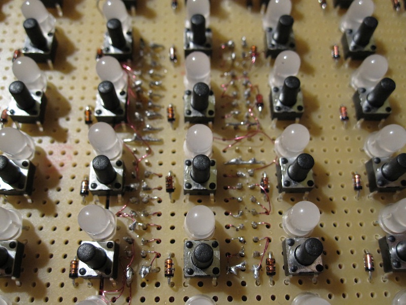

...and to connect the matrix wires
TK.
Please note: soldering such filigree wires is time consuming and requires some dexterity.
It will work perfectly with double layer PCBs, but if you really consider to build the BLM on a prototype board like me, it's probably easier to add sockets at the bottom of the PCB (thats my conclusion after all the work)
