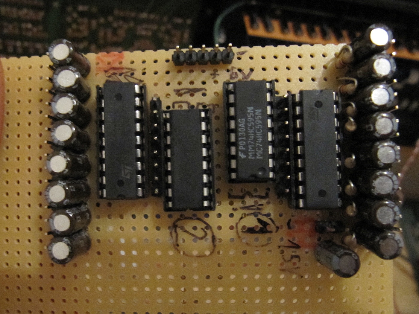

this is not a part for the Crumar organ... the crumar gates are V-Trigger @ 15V but i have a other organ that needs S-Triggers --- for that i made this board - 16 notes, 2xhc595 and 2x uln2803A
