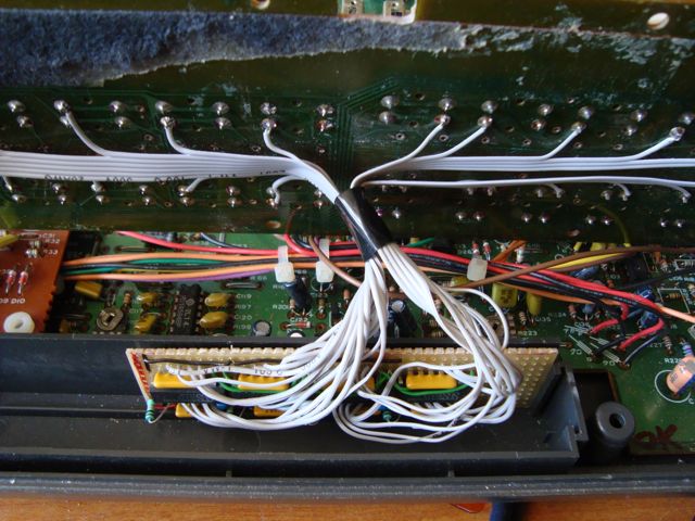

Originally, tactils switches were matriced, but the functions need DINs, so everyone on DIN.<br><br>
I replaced some switches too. I have room in battery compartment. <br><br>
Note: original power supply was replaced by a LM317 @6v and the switching system between battery and ext was removed.
