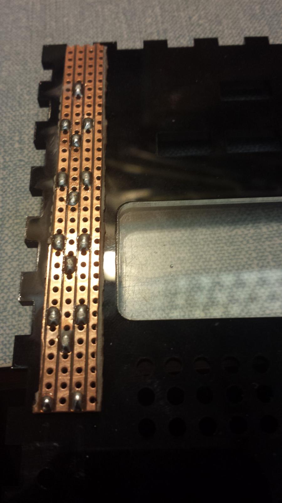

  5. Hardware done! Used tiny 100k trimmer pots with the legs pushed through holes in the perspex and a small vero board for 5v, ground and divided Vout. Shown also are the cables from the analog inputs, and 0 and 5V from labelled points near to the midi sockets. Thanks for your help, will post when it's working with the software :#
