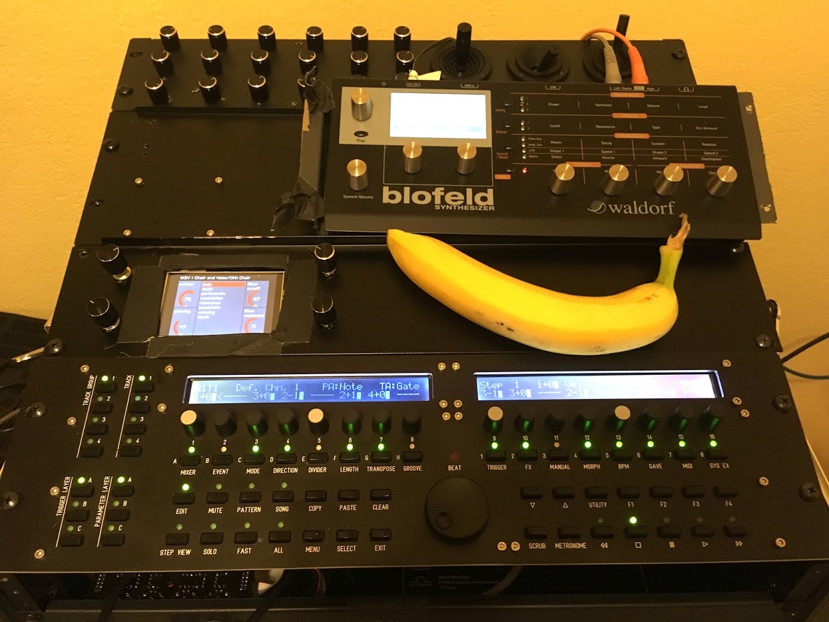

Hello, first of all I have to say THANK YOU to Thorsen for this amazing sequencer and platform. I just finished my build recently and I am already in love with it. Also HUGE thank you to Julian over at thebeast.co.uk for making the front panel at a reasonable rate, it is absolutely gorgeous. However, I'm having an issue with midi routing and I'm hoping someone can help me out. I'm trying to send track notes to two synthesizers at the same time. I've set a note track to send to BUS1 Channel 1, and in the midi router I have set IN to Bus1 All channels, and Out to OUT1 All channels. Photos are attached. The problem is that I don't get any notes out of OUT1. If I change the track to send directly to OUT1, Channel 1, I can hear the notes. Please help, what am I missing? Also attached is a photo of my build :)
