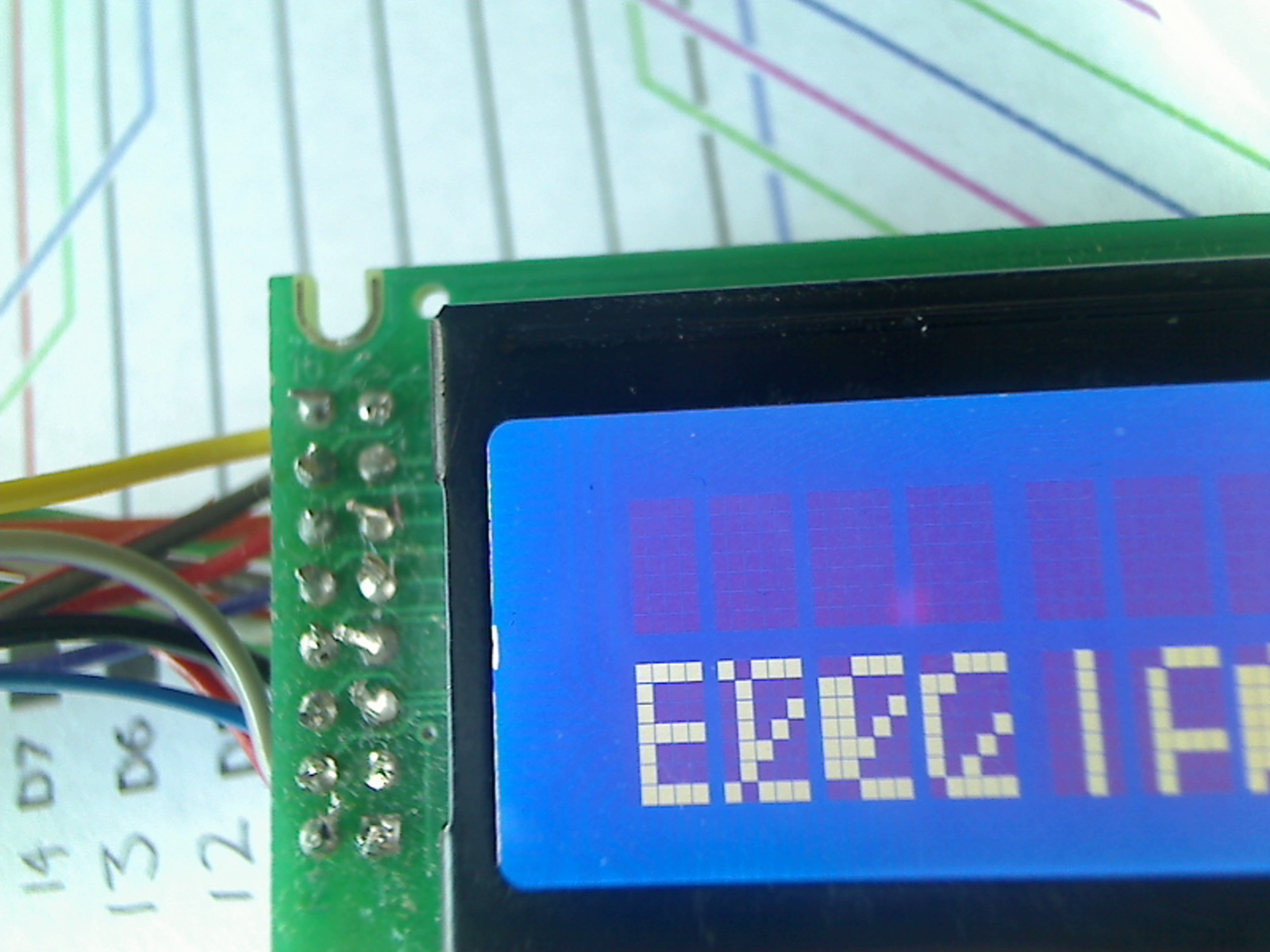

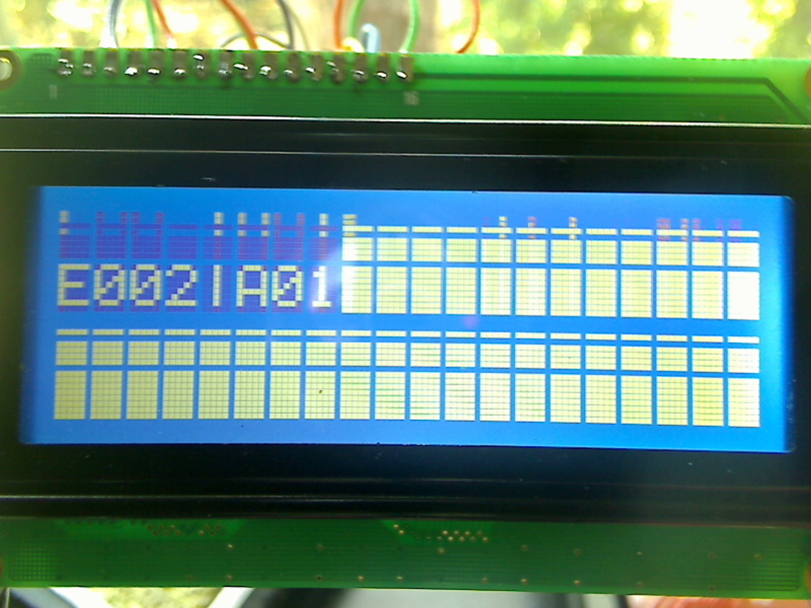

So I've managed to break two LCDs so far, or so I think. I'm not familiar with what constitutes as a 'broken LCD'. Let the trial begin! Exhibit 1: Notice that the first character of each row is missing a column of pixels, and it causes every fourth character to skip a line. Exhibit 2: This is the really frustrating one. I followed Jim Henry's guide to making an LCD cable. Just as he said, the wires are a little flimsy and tend to break after a few weeks. I resoldered the wires, triple checked my connections, and then I was met with this garbled mess. The LCD worked perfectly before I had repaired the wires. I bought both these LCDs a few months apart from 411techsystems. The verdict? Common errors? Irreparable? You be the jury.
