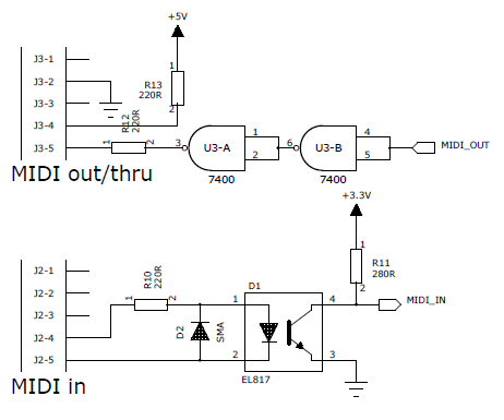

I've pulled MIDI DIN ports off of an old M-Audio M-Box. I'm going to plug it into a breadboard
and route it to pins on my Altera DE2 FPGA Dev Kit is it OK to connect it directly to digital logic
directly off of the breadboard? Is there any protective circuitry that needs to be in between?
Thanks
Malik
this is part of someone's schematic on electro-music.com's forum
would this be all i needed to perform MIDI I/O safely?
