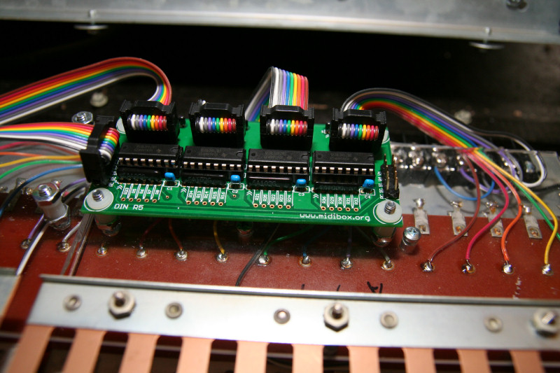

tonyn Posted January 8, 2010 Author Report Posted January 8, 2010 Well I have been troubleshooting that bad Din circuit board. I ohmed out the traces, and even swapped out the ICs. Actually all 4 jumpers, pin#4 of them cause shorting to to pins of All ICs. The reason I didn't initially find it with the 4th jumper was when testing it with the pedalboard, which only had 25 contacts, pin #4 of J6 was for note 29. But testing it in the accompanment keyboard showed that was bad too. Pins# 4 of these jumpers use the first pin of the resistor networks and is close to the caps. I looked for shorts there too but couldn't find any. My only thought now is that I may have the resistor networks reversed, which shouldn't matter. I did put these in the reverse of the first dins which were all good. If that isn't it it maybe the caps. Those are also in reverse, but this shouldn't have mattered either. I hate the idea of desoldering these components, since I don't want to destroy them or the board in the process. But there is not much on these boards, other than the board itself, that can be bad. My soldering I closely inspected, and it seems all good. Quote
tonyn Posted January 8, 2010 Author Report Posted January 8, 2010 (edited) Well, the din is fixed(resistor network oriantations make a difference). But now I have a cut Midi cable from the computer! I have no idea on how that happened! It could be from the metal on the back of the Solo contact board(it's a bit sharp). So I'll have to make sure that when the Solo contact board is turned up and down it has clearances to not to cut into anything. I am making a couple of Midi cables today anyway to daisy chain the keyboards and pedalboard. So I might as well repair that now too. I will also leave the dust covers off until I am pretty much done with the organ. Then I'll make the cutouts for the power, Midi cables, and aux output from the keyboards (I have 3 spare inputs per keyboard midi circuits from the dins, which is 6 total, enough to use for my pistons). The dust covers just attach with clips in front and screws in back. Edited January 8, 2010 by tonyn Quote

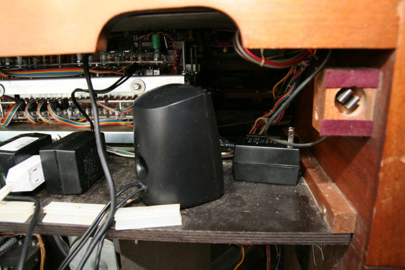

tonyn Posted January 8, 2010 Author Report Posted January 8, 2010 (edited) The rest of this weekend I'll be planning out the Midi cabling , power cabling, power strip placement, UPS battery and circuit placement, and computer power supply placement. The battery and computer power supply I hope to put on each side of the keyboards in back, since, hopefully, there is enough height for those there. The power strip in back behind the keyboards. I'll run most of my cabling on the left side of the organ, since I have my cores on that side, it makes sense to run the cabling on that side now too. Plus the hole that is near the pedalboard circuitry comes up in the back middle area, where I want to put the powerstrip. But there is a hole on the left side with plenty of room to run cables down to the amplifier and pedalboard circuitry areas. After that is all done I'll be figuring out how to make the pistons into momentary push buttons, and wiring them up. Pretty soon I'll be re-designing my stop area console and planning out the Midi circuitry. This will be designed on the computer (I'll design a virtual console to play with in Jorgan, etc., and if I like it, it will go physical), so I can see what it will look like before I physically commit. I'll also be looking at the old organ Tremolo(leslie motor), circuits and control, and amplification circuits to see how to get them working too These parts will take me a lot longer, since next week I have to start looking at my schooling and won't have much time for the organ. But at least it will be completely playable with the virtual organ software, using the touch screen for the stops, and 10w computer speakers for sound output! Edited January 8, 2010 by tonyn Quote

tonyn Posted January 10, 2010 Author Report Posted January 10, 2010 (edited) Well I am finished, for now, and won't be back at it for maybe a week, or when I have time. Tomarrow I need to concentrate on going back to school. I found these rubber things (left over from the front of the Solo contact board to protect wires to the old circuits on the front of the Solo contact board), that I put on the back metal of the Solo contact board to help with NOT cutting the midi and power cable wires from the Accompanment, when it is tilted up. I repaired the midi cable from the computer, made 2 custom midi cables out of one 5 foot one, to daily chain the cores, and tied the cables up a bit. I'll plan out the power strip, etc., later. I do have the organ closed up and playable, and the computer speakers are sitting inside the organ, down by the organ speaker area for now. The keyboard can be moved to behind the sheet music holder when I want to play, for now. But I am still thinking out how to have a shelf for it and the mouse (although the screen is a touch screen, a mouse still comes in handy) swing in and out of the way, etc. I also have my organ sitting far enough from the window so I can still work on it from behind, etc. My keyboards, pedalboard, and swell pedal are all midified, daisy chained, and work well in Miditzer! But I am still trying to figure out how to configure the swell channel in the Jorgan Dispositions. Since the cores pass signals down the chain, the computer input is to the Solo core (for now, eventually the first core that takes the input from the computer will be the stops core), and output is from the pedalboard core. I can also reconfigure my cores from one input from the computer without changing or removing any cabling. I just upload to the ID of the core I want to change! The cores all have a unigue ID from 0(stops), to 3(pedalboard). So, now that I know how to change the channel of the swell, I may map it to another channel that works better in my Jorgan dispositions, etc. I do have 4 more Din kits and 1 more core kit for my stops to handle up to 128 stops! But I will need 4 Dout kits and maybe an Ain and Aout for the stops, etc. Those I will order next month. In the meantime I can do some breadboarding, etc., to see what I will need. Here's a bunch of pictures for you: Edited January 11, 2010 by tonyn Quote

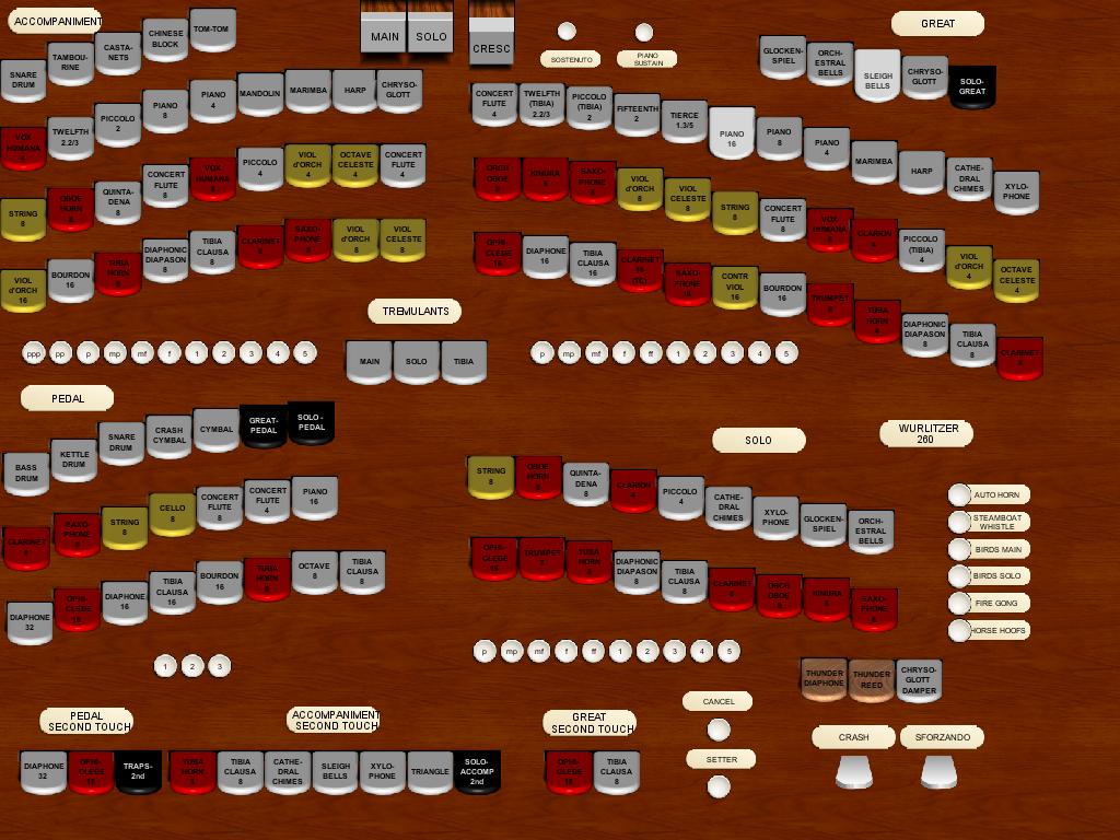

tonyn Posted January 11, 2010 Author Report Posted January 11, 2010 (edited) Now my Swell Pedal also works in Jorgan! I just had to set the Change Message data 2 to: "set 127 | get value" in my disposition, and set the threshold to "0.05". I am using a fluidsynth version of Bruce Miles Wurlitzer 260 (I have the Great and Solo mapped to channel 1 for my Solo keyboard). I also reconfigured midibox to send the swell out on channel 13 (easy to do as I said with my core chain, I just upload to the ID of the core I want to change). In midibox channel 13 for the swell is "0xbc" To set channels for the swell pedals in Jorgan you just change the status from 176 to 176 + channel# For channel 13 it's "188". Data 1 = "7" At least that is what I have set for now. BTW: My first class for this semester actually starts January 26. So I have a couple of weeks yet to play with the organ. Right now I am working on the virtual organ software, photoshop, etc., and dispositions I want for stops, etc. Since I like all of the bells and Whisles of the Wurlitzer 260, I most likely will use one of the Wurlitzer 260 dispositions for the sound fonts, etc., and just design it into my organ console's stops, as a start. Once I get more of a hang of Jorgan, I can then add neat features from modern organ examples, and think out how to to it physically too. I like the full customization of Jorgan! Then, to switch over to true sounds, I will play with the free version of Hauptwerk, etc.! Eventually I want to start doing some virtual organ coding myself, and make a nice custom GUI shell for the virtual organ programs, maybe in Java(cross platform, so this is what I want to consentrate on) or Visual Basic, etc. I haven't worked with Java other than Java script for websites. But this semester I'll be taking Java at the college to learn more about it, and to apply what I learn to this! I will then change my organ computer's operating system over to Linux(this I have worked with before, so I know linux). Right now it's crappy Vista(I hate Vista, but it came preinstalled on the organ computer). I may change over my motherboard for my organ computer next month too! I want at least a dual core(I thought I got one but it isn't), with enough expansion slots for at least 3-4 sound cards, and a side buss to make it 1 unit high so it will fit nicely in the top of the organ. My cards right now maybe too high. Or get a good integrated motherboard with good sound, and figure out how to send out to the different channels of the sound. I am using fluidsynth right now with the integrated sound, so I could do something like that, and have no cards on the motherboard! Here's a screen shot of my current Jorgan Wurlitzer 260 console. This is pretty much untouched and is the default. I am playing this now with my organ, and to me it actually has better sound than Miditzer 216! I'll also make various consoles of modern organs to map to my physical stops, etc., using photoshop, etc. When I am happy with a console layout for Jorgan, I'll then make it physical. Until my stops are physical to the virtual organ programs, I can use the touch screen for various virtual consoles! Even after that, I can always call up virtual organ consoles for more organs! Love the virtual stuff! Edited January 11, 2010 by tonyn Quote
