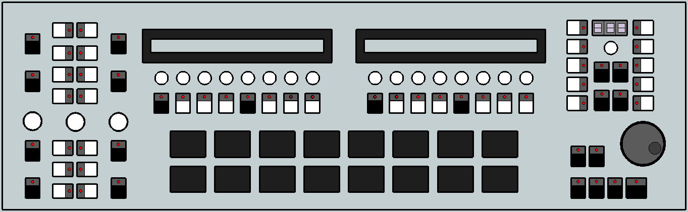

mirrorcrypt Posted December 6, 2009 Report Posted December 6, 2009 (edited) Hey, I had a similar idea except to tie it to the mbseq somehow. For me, a sequencer with pads and the 16 general purpose buttons and knobs would be a killer controller and cut down on the number of boxes cluttering up the studio. I thought about hacking a cpl. Akai LPD8's or a replacement pad set for an mpc1000. I think having the pads integrated into the control surface of the sequencer could be useful for doing track mutes and/or track solos. The sticking part for me is the programming aspect, ie. bank select, note mapping, pad sensitivity, velocity and then how to possibly extend the functionality to include track mute and solo........ Maybe the programming aspect could be integrated into the mbseq or used to create a standalone box of pads. here's a sketchup of a possible panel design that shows the mpc1000 pads to scale below the general purpose knobs and buttons on the mbseq. It is 23" long and 7" deep: Edited December 6, 2009 by mirrorcrypt
