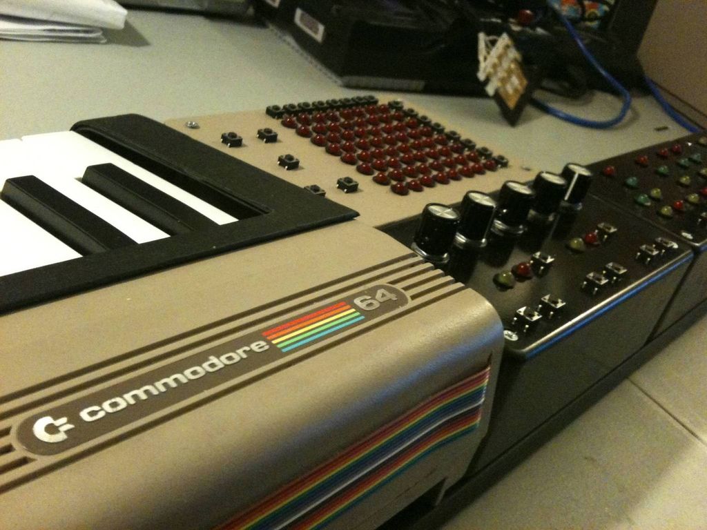

jbartee Posted February 19, 2010 Posted February 19, 2010 So I'm nearing the completion of my midibox sid, and I've run into a strange issue. All the LEDs in my 8*8 matrix are a nice even brightness, but only if there is no more than one led lit per column. As more leds are lit in a given column, the brightness of all the leds in that column begins to dim. Adjacent columns are not effected, and neither are the other leds running off the same DOUT module that are not in the matrix. There shouldn't be a problem with my power supply as it's capable of outputting 2 amps. In fact the current before the shift registers seems not to matter; I tried putting a couple thousand uF capacitance directly behind the power input of the concerned dout module to buffer the current, and it had no effect; therefore it seems like this is an issue with the current throughput of the pins on the shift registers, or something to do with the duty cycle of the multiplexing. I'm curious though because I haven't seen this behavior on videos of other completed midibox sids. I'm using 5mm red leds from SmashTV. I've tried a variety or resistors and the issue persists no matter what. So what's going on here? Is this a limitation of the chips? Some other problem? 5mm a no no? Any help at all would be truly appreciated...

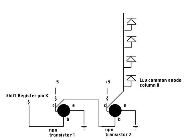

jbartee Posted February 20, 2010 Author Posted February 20, 2010 Just to clarify what I mean, here's a crude schematic. This way, when the pin is high then 5 volts are supplied to the column directly from the power rails instead of via the shift register. I implemented a simple version of this on a breadboard (just one LED) and it works in principle. Guess I'll throw it all together and see if it fixes the issue!
