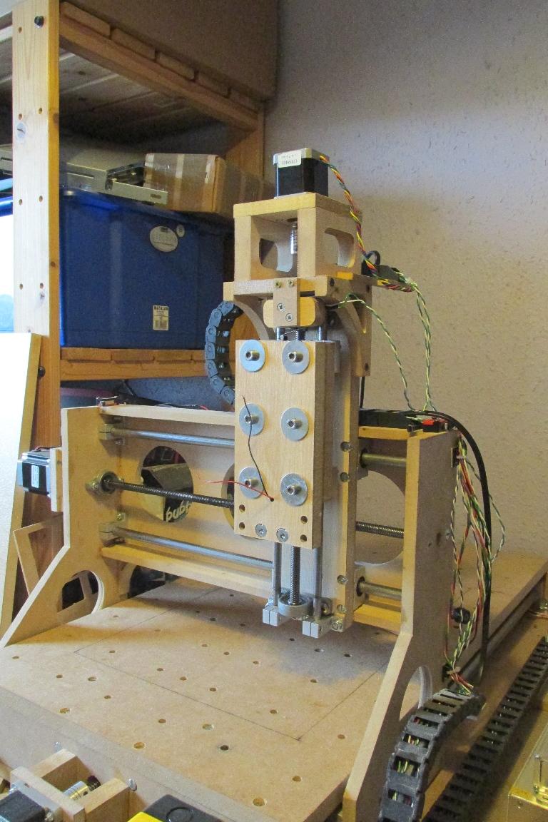

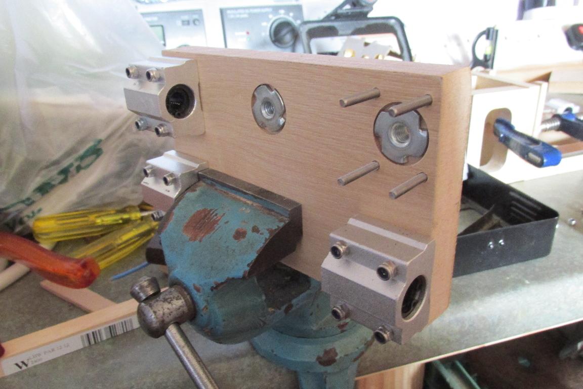

Now construction starts, First with the slider... pressing tee nuts into their recesses before I can fit the linear bearings - these are where the tool mount attaches.
post-7782-0-88771600-1374177432_thumb.jp

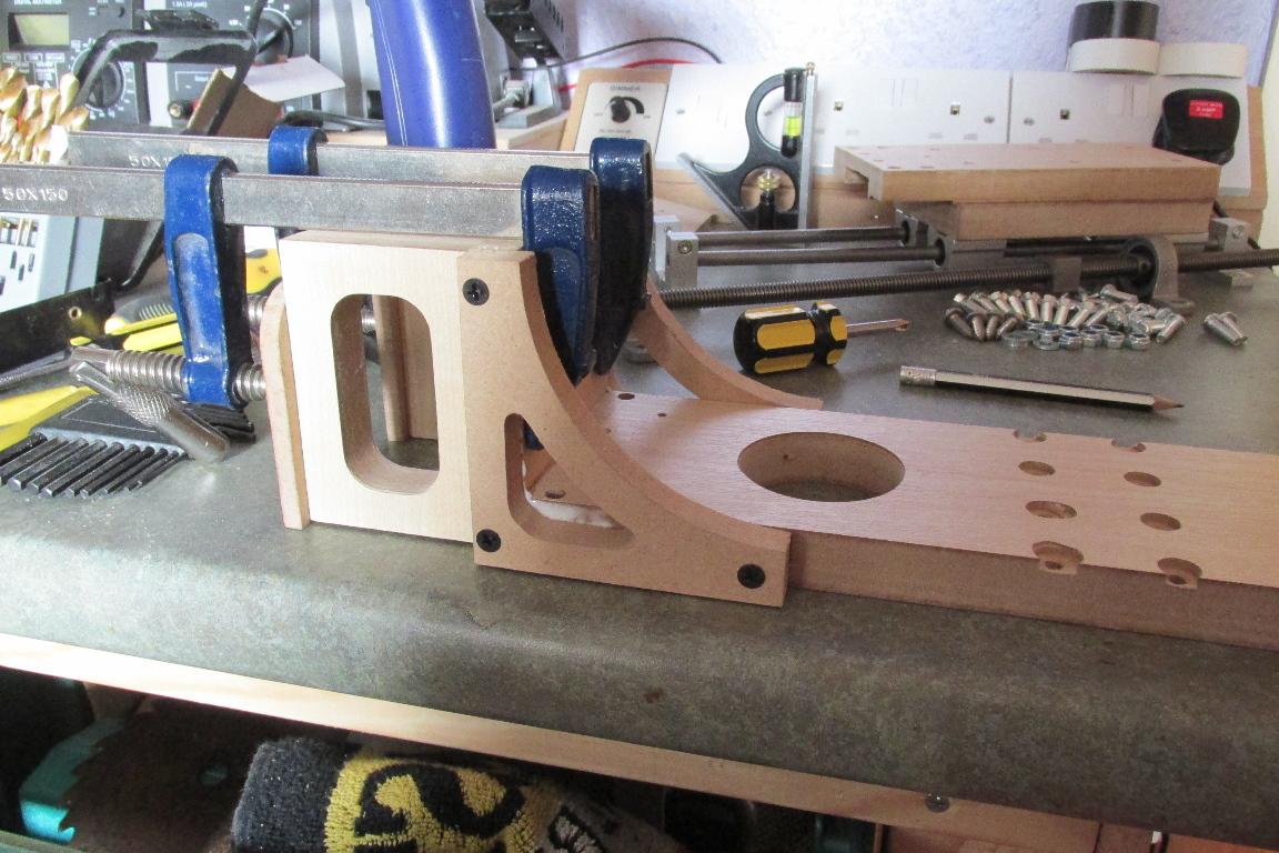

Next the main body of the motor mount is glued and screwed to the base. Thanks to the parts being CNC cut... it fits perfectly square.
post-7782-0-89807700-1374177439_thumb.jp

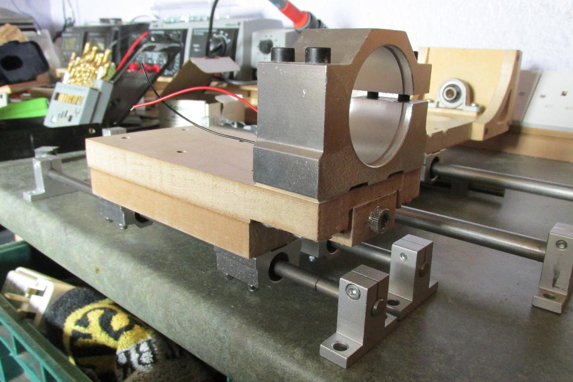

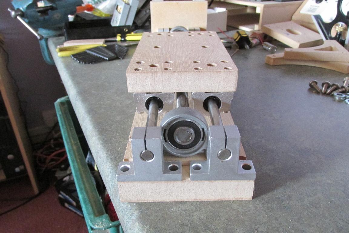

Then comes a dry-fit of the rest of the hardware to make sure my calculations and cutting is accurate...
post-7782-0-56133300-1374177446_thumb.jppost-7782-0-77996900-1374177459_thumb.jp
All looks good and the nut is in perfect alignment to attach to the back of the slider...
post-7782-0-04511900-1374177453_thumb.jp

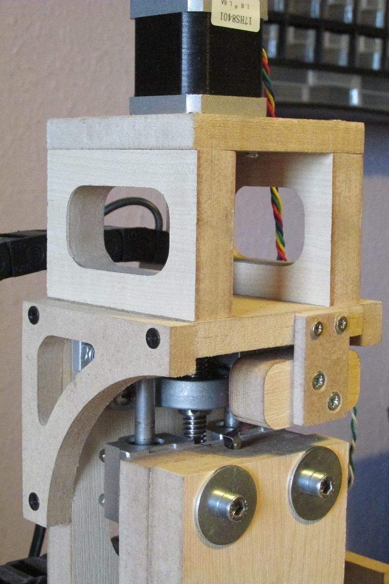

Adding the side supports for the motor mount, and test fitting the tool mount shows that all looks good to go for final assembly and fitting to the machine...
post-7782-0-42736900-1374177467_thumb.jppost-7782-0-05584000-1374177474_thumb.jp

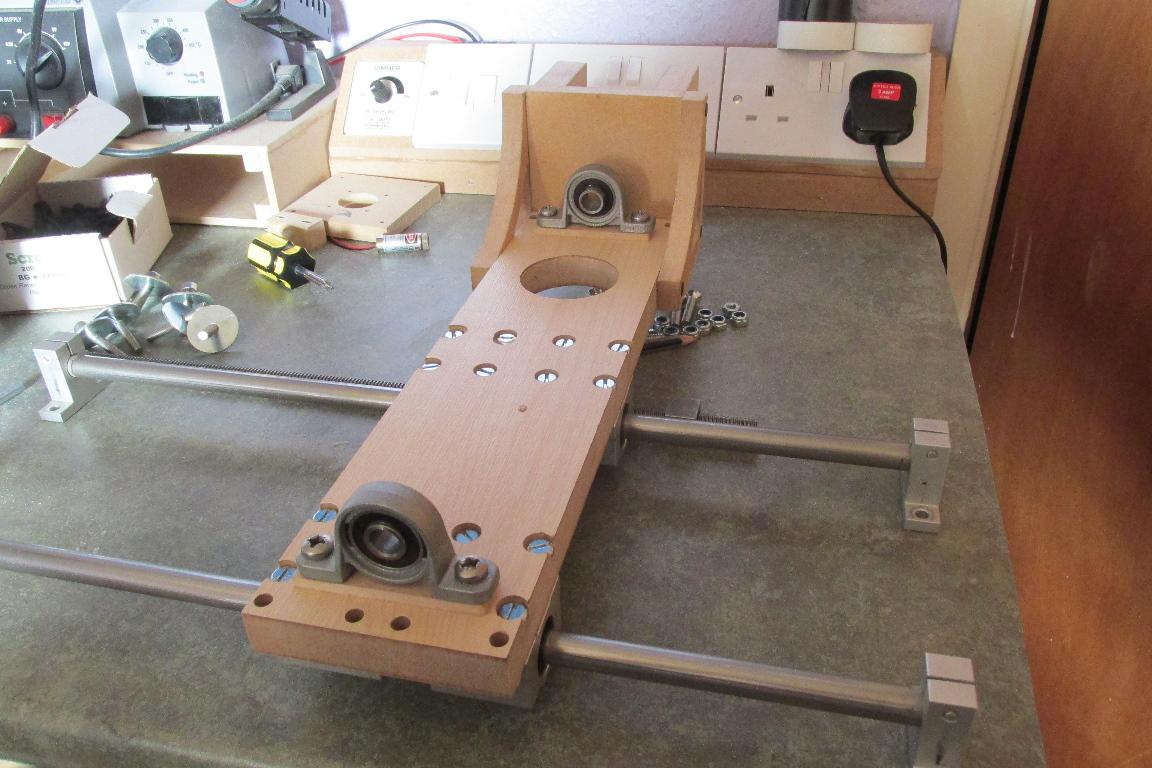

Continuing the rebuild..... I've removed the old Z-axis, and found that my DIY anti-backlash nut had split between the threaded inserts, which was causing the sticking.
The first parts to assemble were the Y-rails onto the rear of the Z-axis, then I could fit the leadscrew bearings. (space was tight, and the lower bearing covered two of the mounting bolts on the lower set of linear bearings)
post-7782-0-12473900-1374687076_thumb.jp

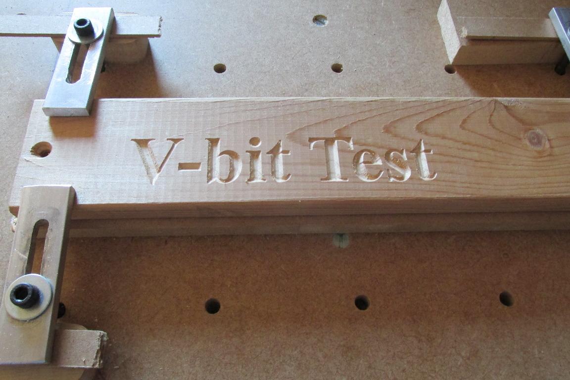

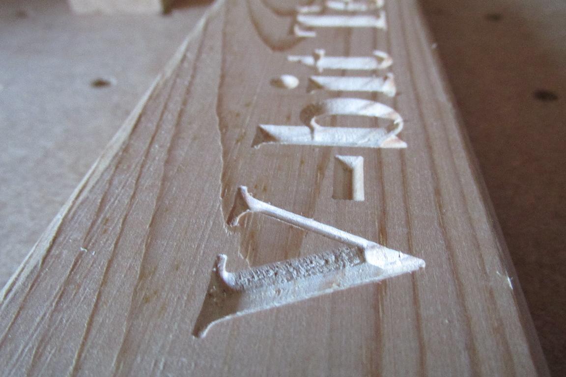

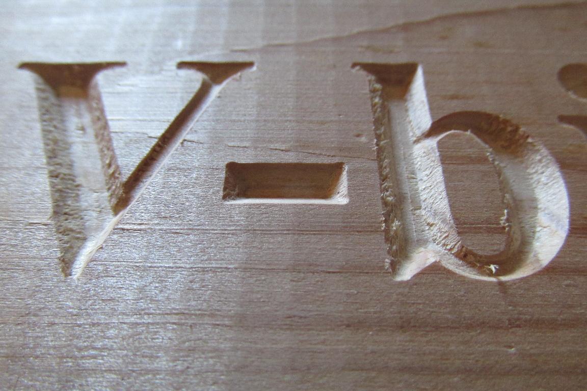

It's crunch time !!!  Time to see how it cuts
With a V-carving bit in the spindle, and a test program loaded... see the results for yourself....
..and here's some stills of the results..
post-7782-0-66300800-1374832754_thumb.jppost-7782-0-43235400-1374832759_thumb.jppost-7782-0-44268400-1374832763_thumb.jp
