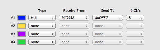

fourfour Posted June 3, 2013 Posted June 3, 2013 Hey everyone. I am having trouble getting Pro Tools to respond to my controller. I have it setup in Pro Tools as HUI, but nothing seems to work. Is there a setting I need to declare in MIOS for HUI Emulation? Or is that always available? Setup: LPC17 NG DIN Thanks! -eric (the attachment shows the MIOS in italics, I just had it unplugged when I did the screenshot)
