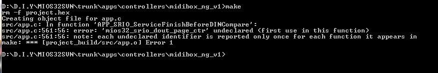

Marxon Posted August 29, 2014 Posted August 29, 2014 Hi! When i try to compile the original Midibox NG app from the SVN then i get the following error: First I suspected there is something wrong with my toolchain or system variables but other MIOS32 apps compile without problems.. Maybe there is a bug in the actual SVN source? Does anyone else get the same error message? Best regards Marxon
TK. Posted August 29, 2014 Posted August 29, 2014 You've to update the complete repository, not only the application directory. If this doesn't help, download the complete repository into a new directory (maybe you did some local changes?) Best Regards, Thorsten.
Marxon Posted August 29, 2014 Author Posted August 29, 2014 (edited) Hi Thorsten Unfortunately this does not help. EDIT: I forgot to do a restart after i had changed the system variables. Now it works! Thanks a lot. :thumbsup: Marxon Edited August 29, 2014 by Marxon
