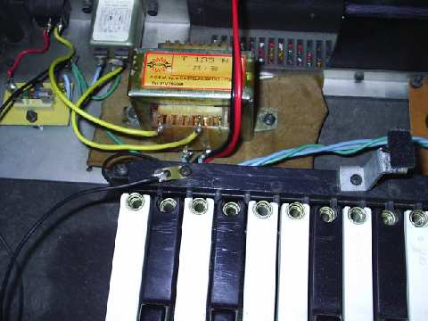

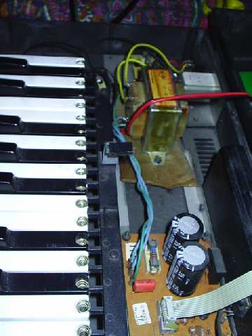

after checking that the power supply of the keyboard ouputs 12V, i soldered to wire at its output, and let the wire exit from the master

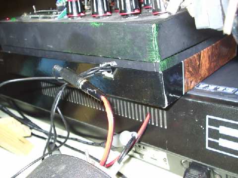

the wire exits at the back and connects to the midibox

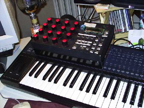

now my setup look like this:
and when i turn on the masterkeyboard also the midibox switch on.
