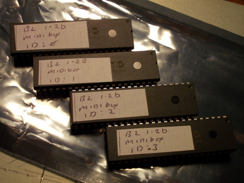

Chips burning session tonight. PIC4685 all burned, MIOS Loaded and basic test done. Reading through the notes, and using MIOS studio makes me realise just how much hard work TK and others have put into this. All went very smoothly.

blogentry-4729-0-74753900-1356066748_thu Mini production line
blogentry-4729-0-76460200-1356066781_thu And the results
