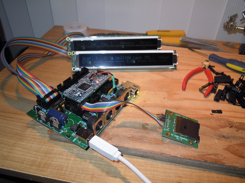

Assembly of the LCP017, the SD Card adapter, and the 2 screens ! I'm on the way !!!

Where did you get this SD card adapter board? Is it a MIDIbox thing or a regular commercial product?
gslug
Posted
@Saurean: I'd like to know this too. I have used a couple of SD card boards from Ebay, but they don't have mounting holes.

Lamouette
Posted
Yes it's this one, I have some problem with it because, when a connect it to the usb port of the computer, the software regognise the SD card, (so i had upload the bootloader on the SDcard), but when i only power the SEQ, i can see on the screens, ''no SD card'' (or something like that)
There was some SMD components that i didn't use ont he card, maybe the problem come form them...
