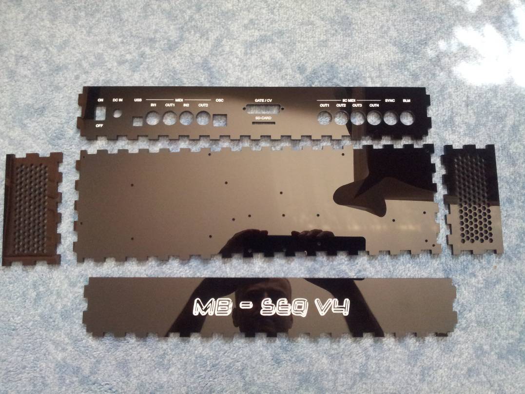

fresh with paint filled laserengravings...the paint filling i did myself...its very easy but you have to be quick to remove the paint that is to much with a soft and sucking tissue. not all the paint keep staying in the engraving by this procedure but enough as you can see! :-)
