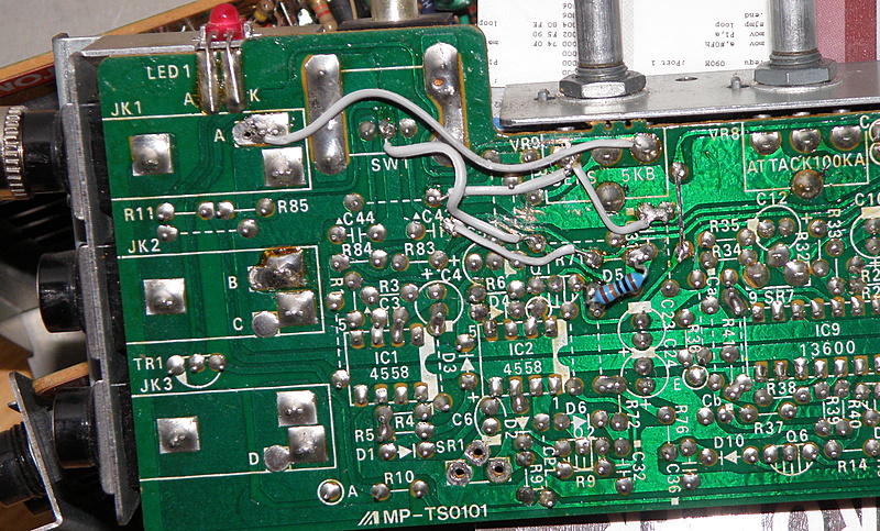

the broken TOM4 Board... the wires, are the "Repair of that Broken Board.
The 100K Resistor well --- that is the BOOOOOOOOOOOOOOOOOOOMMMMM Mod!
The Amp Decay gets longer!
Finally i used a switch and the 100K, to switch between the extremes... the 100K make the VCA open all the time if the Decay Pot is on max!(only if it was triggered before...)
