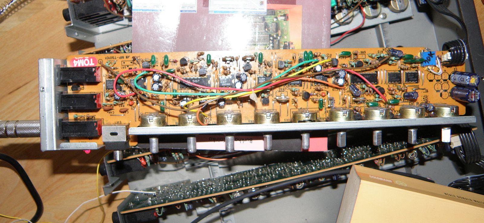

the TOM4 Board was way to silent - I replaced the R1 or should that meen RI? (next to Rm) with an 10K Trimpot.
Now I Have a Main-Gain - to Level the Voice togehter - to my whises
finally i de-soldered the Rm - since i dont want stereo... i noticed when i go mono, i reduce some humm-sound...
this because i removed the MIX-Board... i think on the mix board, when you connect only one channel, the other was switched to ground... i guess... and of course, the 10K Trimpot do the job excellent...
