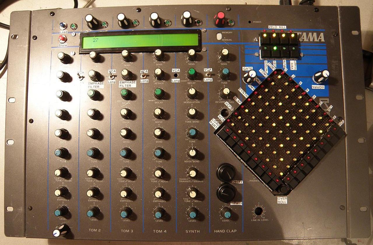

yes a fiew mods i want to make... but i need more pots and switches to do that...

Awesome!!! Whats it all do? Did you install a sequencer? I had one of these and they ar built like a tank... Post an audio link...

no sequencer, i sequence it with a korg electribe rythm mkII
the LED-Button-Matrix is a- Trigger-Router--- so the incoming Trigger from Midi are routed to different destinations... the routing itself is changed by pressing the left and the right buttons, the basic function of a matrix - known from the sid... but a little more it does... so in "perform" mode i can load with the left buttons "song-routings" and with the right buttons "Roll routings" , the round OVER-ROLL button  between the 16 Buttons is Route momentary all Incoming Midinotes to all Trigger-outs..... the gate Pot randomly kills trigger (pot make the ammount of random) -- the velo-kill Pot offsets the Velocity routing... the velocity is divided by 4 Dout-Pins and differnt resistors.. so this is some kind of "Accent" - the analog finetuning is still done by the orginal Sens-Pot on each voice.
the 4 Velo-Kill Buttons at the top of the matrix kill the Velocity-routing pins on every voice - so only accent notes come thru, or only the not so louds and so on...
the velo-invert button - swap the Velo-Pins ---loud will be not so loud, and not so loud will be loud...
the display and the 4 (+1Red-Menue) Encoder over it, are place holder for the planed Bankstick saving- Programchange thing, and the planed Envelope for Main VCA and Main Filter.  ---
there is a video:
in this video the TEKK-STAR is driven by the korg, but the midiloop is static, i changed it in NO WAY... all the midiprocessing is done by TEKK-Star and me.
