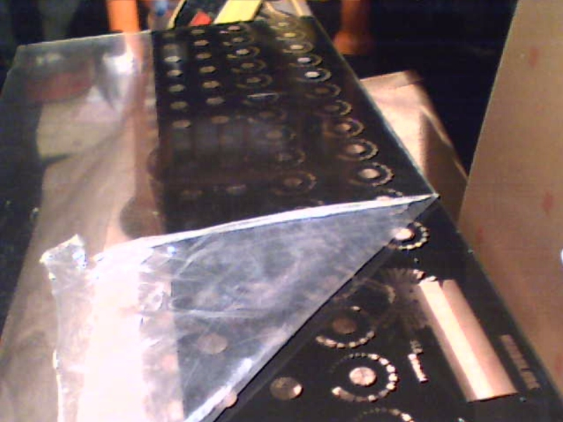

MB64 Tribalista Acryl piece + Silk front panel art (taking pics before drilling so I can see it was clean of accidental scratches)

where did you get this silkscreen done ? how do you do blind holes on the inner side ?

Thanks, but the pic was taken by an China-xing-Ling camera. I wished to take a pic from it with a best cam, but If I go to buy one now, my build queue will wait more!
It was made in a local silk shop of my city. It was very cheap because I asked them to not make a "definitive" screen. So they can re-use the screen again (cleaning the emulsion I guess)
The total cost was about ~ $30 USD (photolithography + revelation on the screen + aplication) + $10 for the piece of acryl :ahappy:
The holes I think you mentioned are from the silk art (?)

the "holes" are 3mm holes to fix the braces/spacers (threaded holes like on the back of Wilba sequencer panel) : how do you fix the veroboard or PCB on it ??

well, pots I will attach directly to the panel then wiring them with ribbon cable in a starlike fashion.(28 pots / 4 cables)
sure I will use 2 PCBs (the whole panel has 40 cm, the pcbs will be homemade and I just found virgin PCBs at 20 Cm ) only for the 16X2 button matrix, because the buttons are tactil ones. Will append that pcbs with screws tha could be 2 mm or 3mm.
