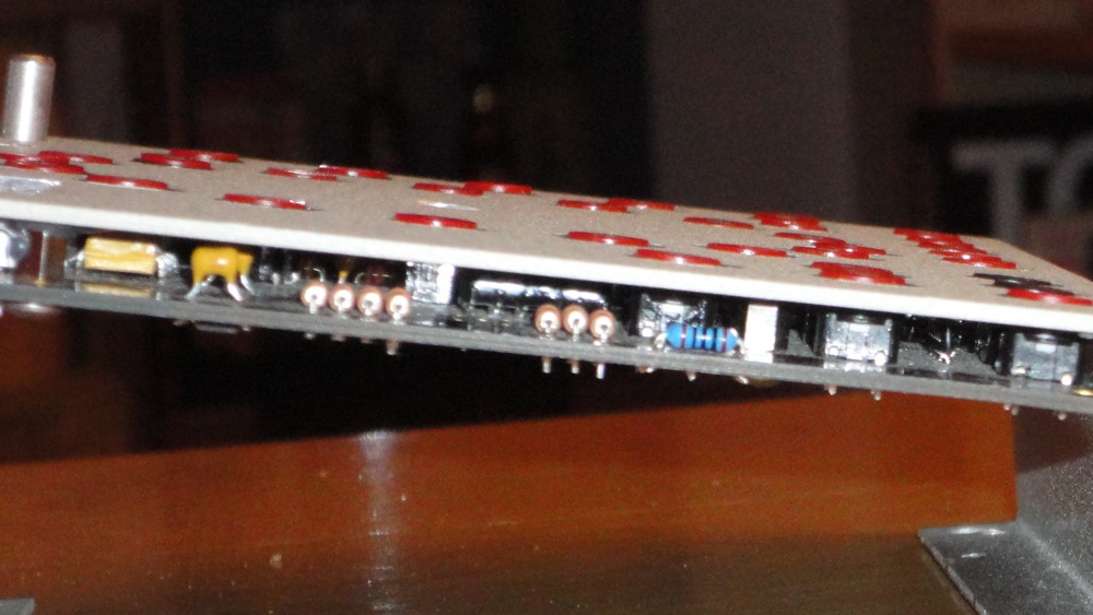

This pic shows the height of the buttons pretty well. It was hard initially to find 5.8 mm spacers, but I'm really happy with the result. And despite an incredibly tough time finding the spacers online, a local surplus electronics shop happens to have thousands in stock!

Thanks Hawk! Getting the right button height took hours of measurements and calculations... the spacers had to be between 5.5 and 5.8 mm. If the spacers were any bigger, the buttons would be flush with the panel, and if they were any smaller, the BPM display would not leave room for a lens.
