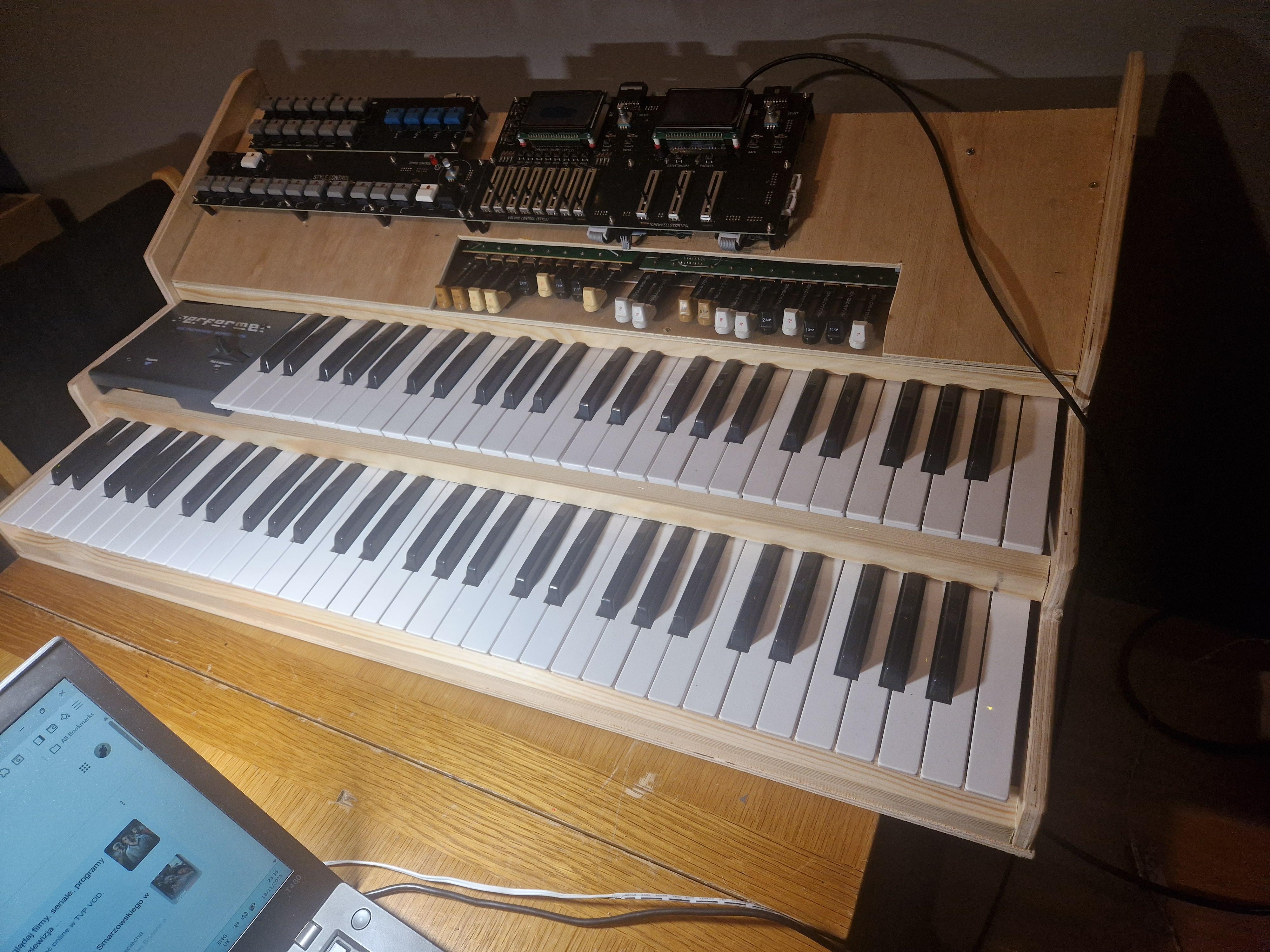

Hi everyone, After nearly a decade of silence, we are resuming our project. What once was merely a concept is gradually taking shape as a tangible endeavor, culminating in my son's high school graduation. I shall endeavor to share updates and photographs of the project in the coming weeks. The initiative is based on the Midibox NG platform, complemented by additional software written in Python that operates on the host side. I wonder whether anyone is still engaged with Midibox NG, as the last official version was released in 2018, and the most recent version available on GitHub dates back to 2020. I ask because I will likely have numerous questions, and I wish to share insights and ideas. I regard Midibox NG as an exceptional concept; it would be a shame if it were left unfinished. Best regards, Bartosz
