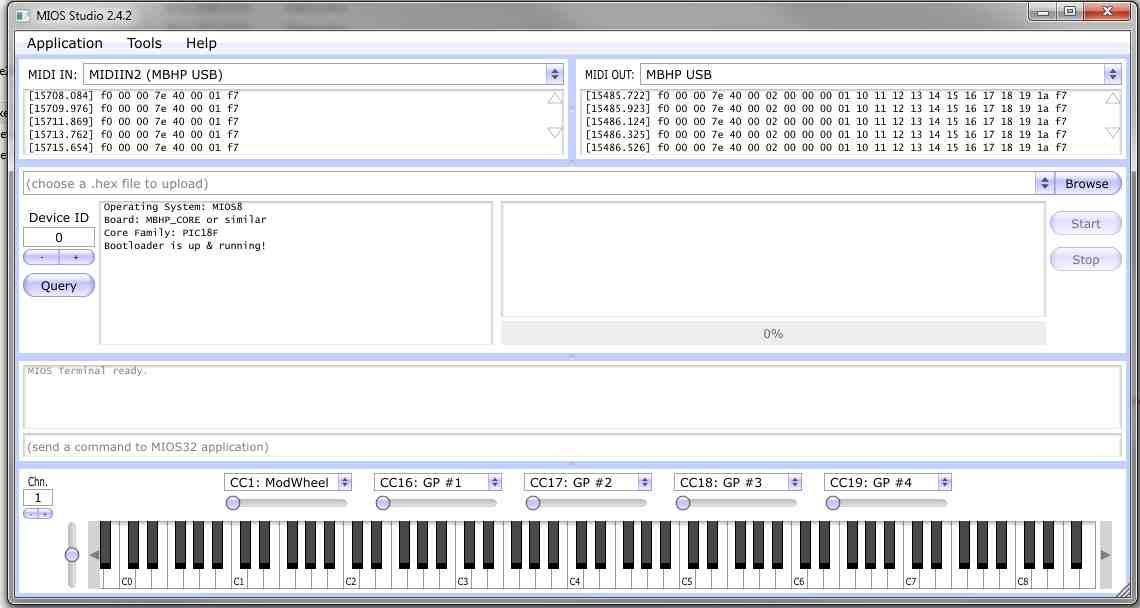

I have a very weird Pic18F4620 here: It looks like pic can't establish a correct midi connection to my midi2usb board - I have 3 core modules each with pic - all 3 pics have the label 1109040 on top - two of my pics are working correct on each socket and can establish a midi connection and I can upload mios applications - for the third pic it doesn't matter which core I try, I can see hex sequence (f0 00 00 7e 40 00 01 f7) every 2 second -> but I can't upload anything - for this Pic I get a valid connection in MIOS Studio only, if I'm using two different MBHP USB Ports which could not be correct (see picture: MidiOut should be at MIDIOUT2) - it also doesn't matter on which MBHP USB port I'm connecting this Pic (both other pics are always working correct) - I can use a Pic 18F452 too and it works correct So, for me it looks like a hardware bug/failure... Did anybody have the same behaviour anywhere? Bye Stefan
