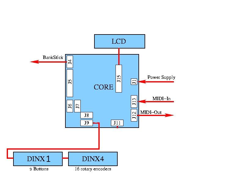

Shuriken Posted October 13, 2013 Posted October 13, 2013 (edited) Shouldn't you connect the DIN1x for switches to J9 and then the DINX4 for the encoders to the DINX1 from the switches? Just as it says in the comment of the pdf you linked to. Just like in this picture, just leave out the led and ledrings. Edited October 13, 2013 by Shuriken

Shuriken Posted October 13, 2013 Posted October 13, 2013 (edited) Hi Shuriken, Thanks for your reply I followed the diagram http://www.ucapps.de/mbhp/mbhp_dinx4_16enc.pdf The pdf says: MIOS based controllers: just chain it with the DINX4 button modules @J9!!! :wink: I edited the picture to show you what i mean. Edited October 13, 2013 by Shuriken
Antix Posted October 13, 2013 Author Posted October 13, 2013 Ok, I will connect like this then I will understand if I have problems with toolchain for recompiling. I think that I havent understood well about the application: I have to write in the mios_enc_table the encoders I am using or the setup will do it for me? If I have to modify the table I am in trouble then because seems that my toolchain dont works fine. Anyway I will put my condition as the shematic you show me then will face any new difficulties, Thanks and best regards
Shuriken Posted October 13, 2013 Posted October 13, 2013 The mois_tables.inc referes to setup_midibox16e.asm for setup of encoders. Since it is already setup for 16 encoders i don't think you need to change anything.
