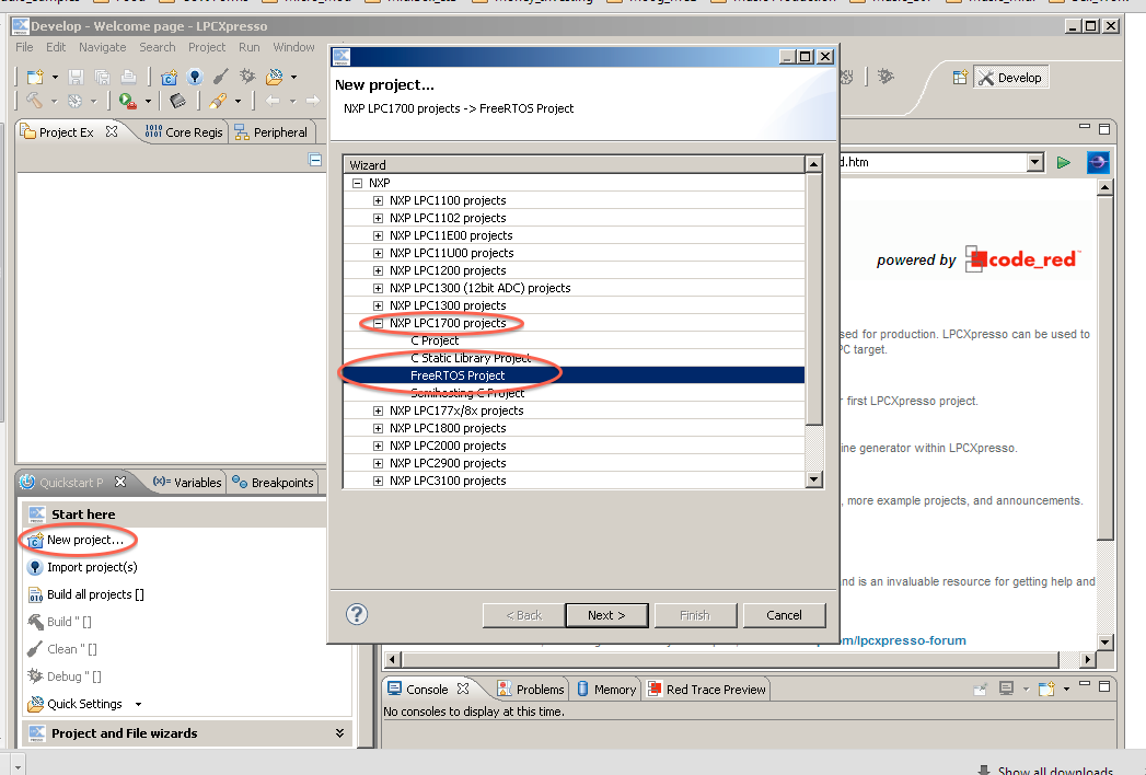

cosmosuave Posted December 29, 2013 Posted December 29, 2013 Hello... This is where I seem to struggle with the Midibox projects due to my lack of experience with micro-controllers and programming... My only other experience is with the stereoSID I built a few years back... I have all my boards made and now I am trying to install the MIOS32 bootloader on the LPC1769... Trouble is I am not seeing the FreeRTOS Project listed in the drop down for new project (see below as per the instructions)... Do I have DL this from the FreeRTOS site and import to the LPC developer program? Also I have DL'd the latest version of the LPCExpesso Developer Program... Thanks... bri
TK. Posted December 29, 2013 Posted December 29, 2013 Here a link to the related thread: The IDE has been changed, so that my installation guide doesn't match with the current version anymore. I don't think that you've to download FreeRTOS or any other additional resources (see the linked thread), because you only want to flash a prebuilt binary. Best Regards, Thorsten.
