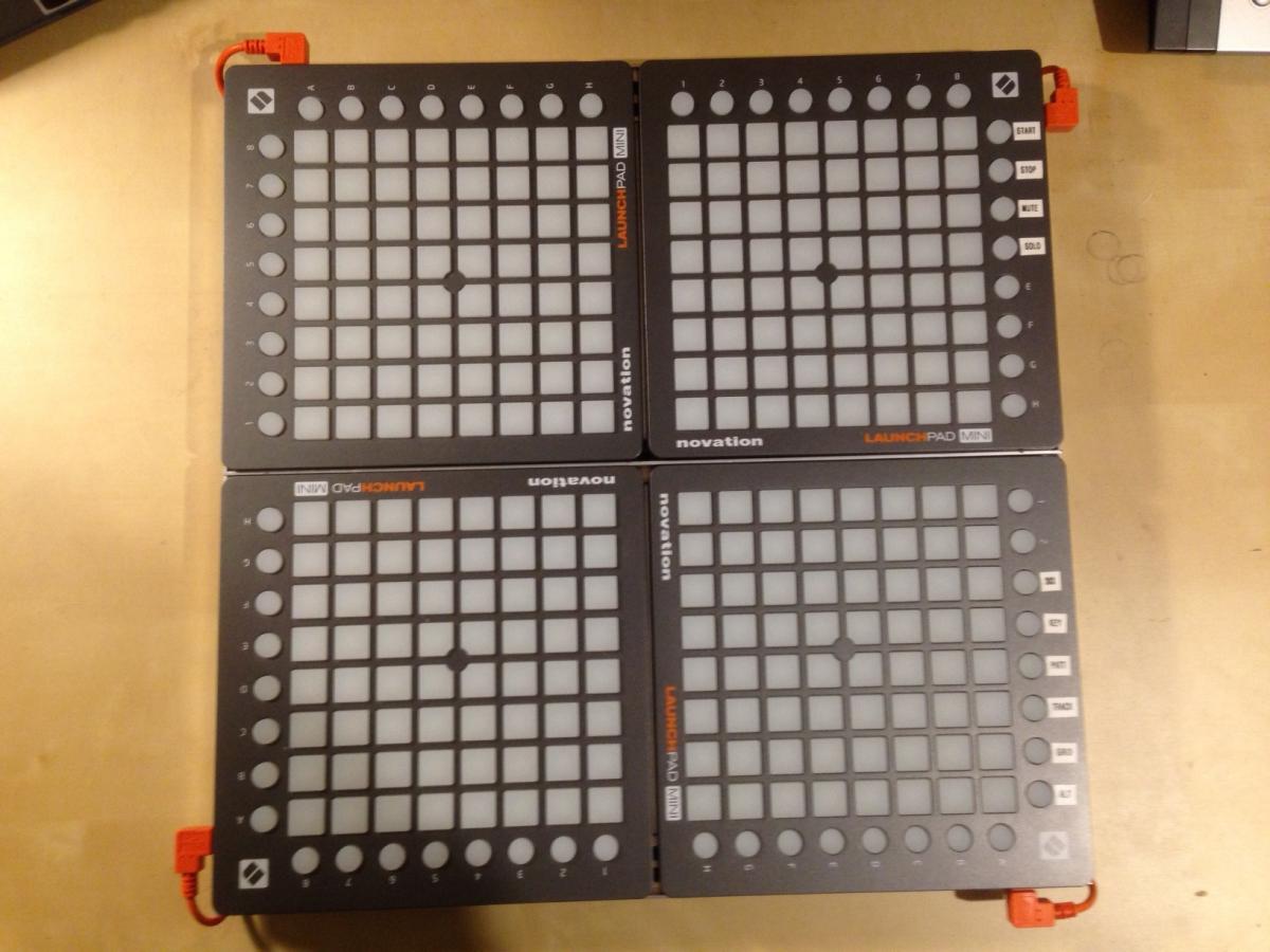

Rowan Posted December 18, 2014 Posted December 18, 2014 I can confirm that 4 x Launchpad Mini arranged in a 16x16 matrix works with 4.087 firmware. One feature I think that could do with some tweaking is the way muting/umuting tracks is handled. The current solution where by you press the track select button twice isn't ideal, especially in a performance situation. My current thoughts are that a new mode should be introduced for muting/unmuting. I haven't thought about how it should be implemented yet in any detail.

Rowan Posted January 3, 2015 Posted January 3, 2015 I'll try the new firmware in the morning. I've made a basic frame today to hold the 4 x launchpads in with a USB hub screwed on to the bottom.
