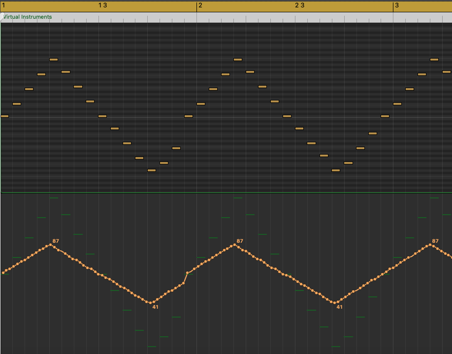

TK. Posted February 24, 2025 Posted February 24, 2025 Thanks for the hint, as you can see I rely on testing meanwhile :) Yes, this was clearly visible - here a recording of LFO modulated Notes and Extra CC as it was before: Should now be fixed with http://www.ucapps.de/mios32/midibox_seq_v4_098_pre6.zip Best Regards, Thorsten.
