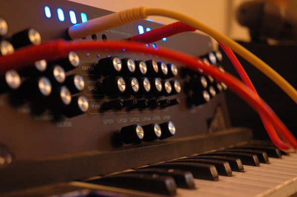

Mr modnaR Posted September 12, 2006 Posted September 12, 2006 i love your midibox! what did you cannibalize to get that case? was it a korg controller for their ms20 etc emulation software?
Alkex Posted September 12, 2006 Author Posted September 12, 2006 Hi Mr ModnaR,Nope, it was an old 70s Bontempi toy I picked up for 1.50€ from a charity shop and resprayed ;DI then had 2 Shaeffer panels made to sizeI would really recommend Bontempi toys for keyboad projects as they are really simple to resolder and contacts are immortal!!Glad you like my Sid CheersAlkex
Mr modnaR Posted September 12, 2006 Posted September 12, 2006 i'd never have guessed! congratulations, it's come out really nice.
Therezin Posted September 12, 2006 Posted September 12, 2006 A bontempi organ? into one of the coolest SIDs I've seen in a long time? That's beyond crazy. I want one. ;D
