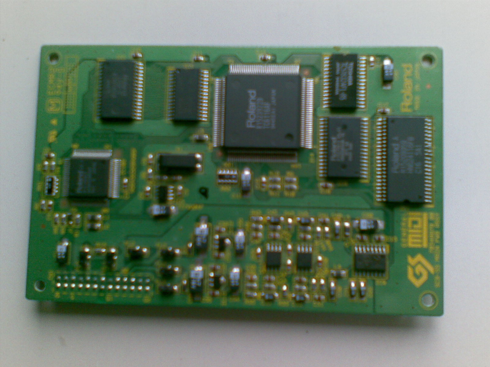

Antix Posted July 15, 2010 Posted July 15, 2010 Hi, I have a WAVE BLASTER CT1900 with E_mu engine doughterboard. Can be the same or the application is only for DB50? regards Antix
mike Posted July 16, 2010 Posted July 16, 2010 Hi, I have a WAVE BLASTER CT1900 with E_mu engine doughterboard. Can be the same or the application is only for DB50? regards Antix At my knowledge all daughter board like wave blaster have the same connection In past I had a Creative WaveBlasterI and after a Roland SoundCanvas; now I play with a Nec Xr385 (sound of waveblaster were worst of other) ROLAND SDBB-55 (SCD-15) YAMAHA DB50XG / DB60XG NEC XR385 KORG AG-10 Creative WAVEBLASTER The difference are the struments and effects. Mike
Shuriken Posted July 16, 2010 Posted July 16, 2010 I have the Korg TopWave 32, NEC XR385 and Terratec Wave XTable. They are all compatible connection wise.
Antix Posted July 16, 2010 Posted July 16, 2010 Ok, Thanks I am already sure for the pinning of the connector but not for the compatibility of the application with this board. You have cleared me. So the creative is the worst of the DBoard :hmm: anyway it is a pity put her in waste as I own and works well. :thumbsup: Is there a minimum of schematic for connecting to a core? I am searching on the forum in this discussion but i found only code file of app. Effectively it is a MB64 whith midi out connected to midi in of daughter but if exist a little schematic will be better. Thanks for any information best regards Antix
