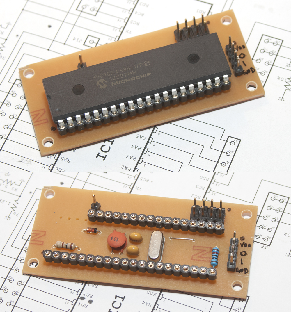

MBSID slave core
Uploaded by
Schrabikus
, May 18 2012 10:21
Nothing superfluous. 4pin Power+midi I/O from Core J11. One pin for CAN and 2x4 pin to Stereo SID module (J14 combined with unused pin)<br />Did i missed something?
